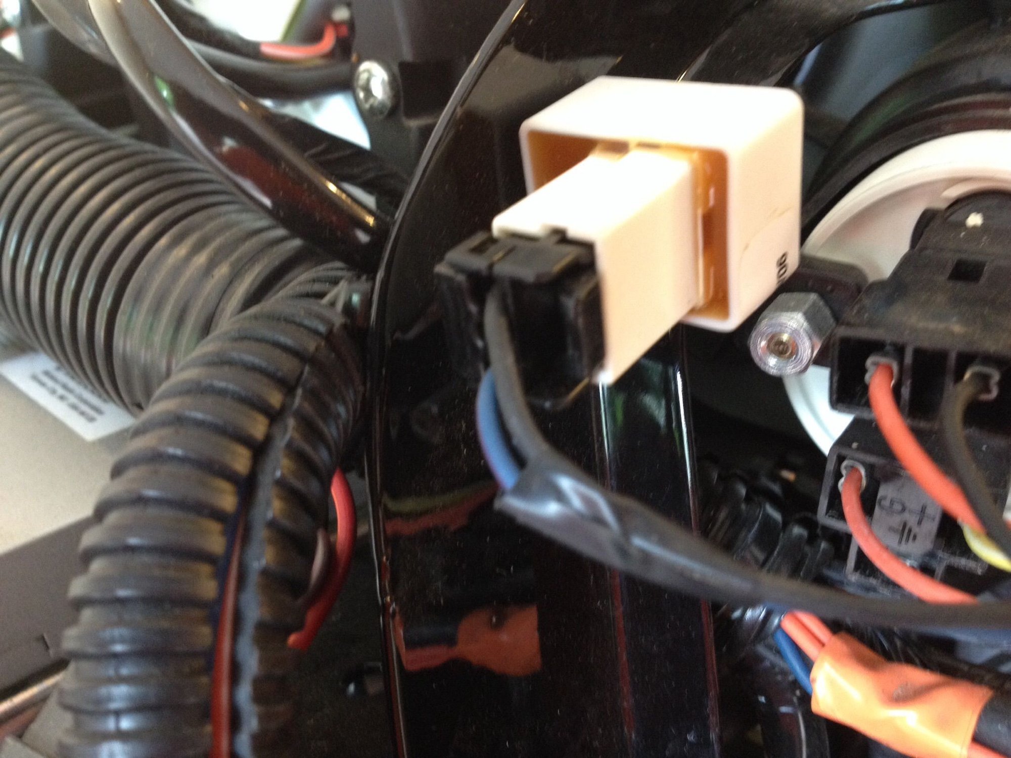

1997 flhtcui, where is the sender for the gauge, I don't see any mention in the book.

This is on an '07 Ultra. (White cube). Can't say if they've changed thru the years. But this is under the batwing, the fuel gauge is just to the lower right. Got a parts book? It should show location.

Looks like it was in the same place on '02 Classics & Ultras. The 2 wires should be: (1) Blue w/Violet Stripe & (2) Black. Just like the photo posted by Ezridr60.
