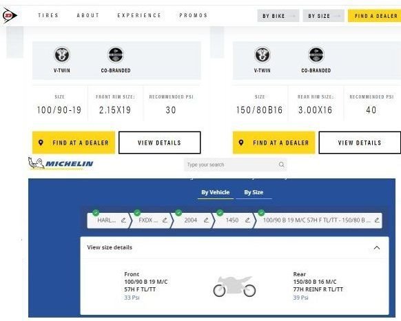

Actually, the tire pressure for the vehicle is specified by the vehicle manufacturer, not the tire manufacturer.
I wonder why Dunlop and Michelin recommend two different pressures for the same tire on the same bike?

Originally Posted by monkeyboy22
i wonder why dunlop and michelin recommend two different pressures for the same tire on the same bike?
those certainly arent the same tires,
