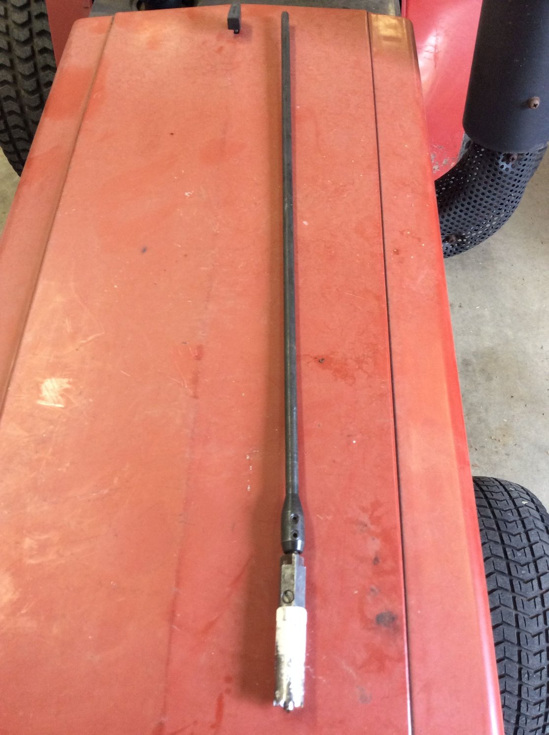

you can just slide a hole saw in there, and drill out the end of the tube.

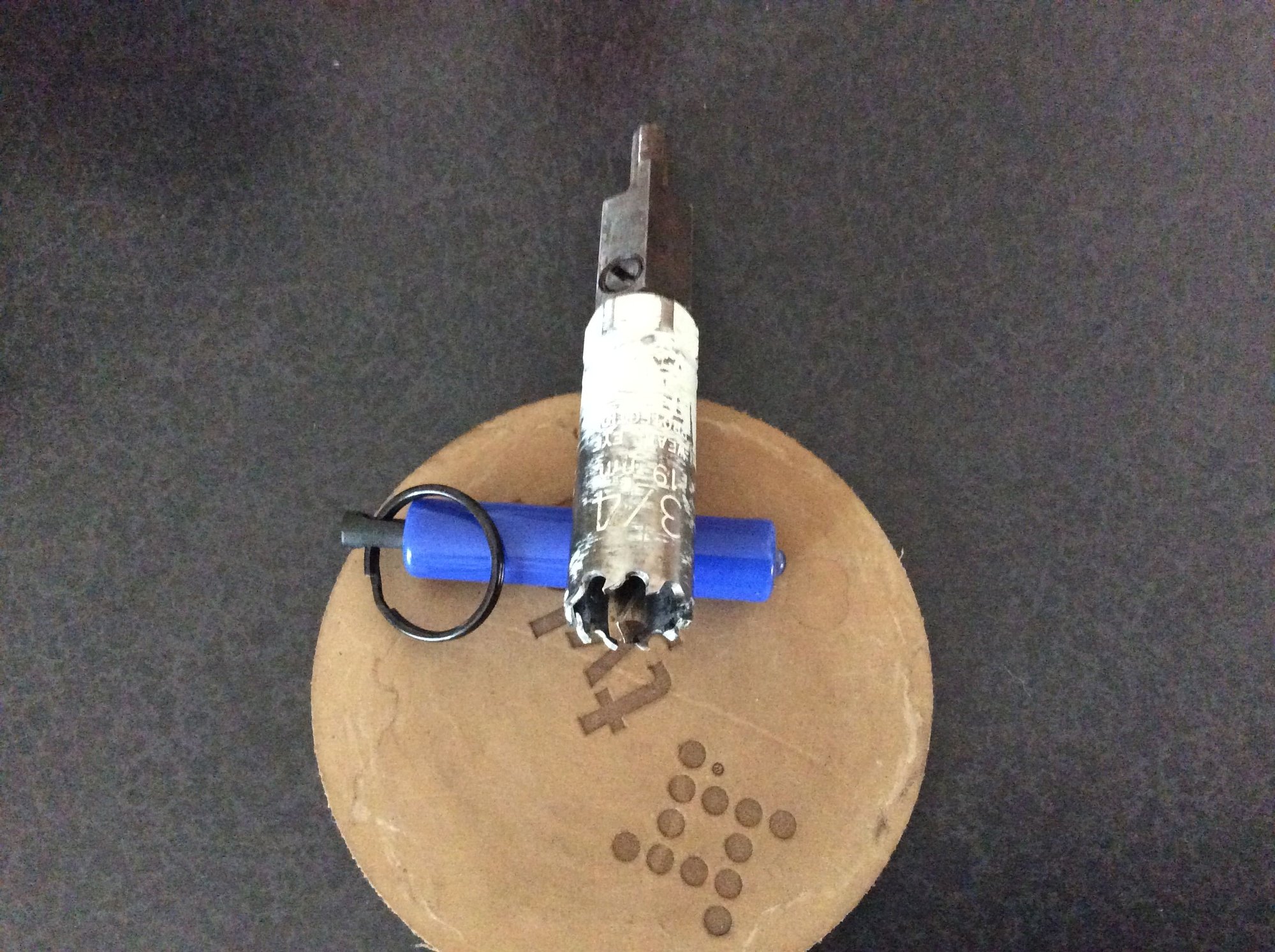

This what I used. I used a piece of pvc to keep the hole saw centered.

the hard part was getting the baffle out, think about it before you do it.
maybe use a smaller bit to separate the two pieces, then a larger bit to make a bigger hole, so you can pull the parts out
I had to waggle the bit around to wallow out the hole so I could pull the piece out

I used a 42mm hole saw to remove the center baffle. Its neat , fast and the hole saw is self centering .
