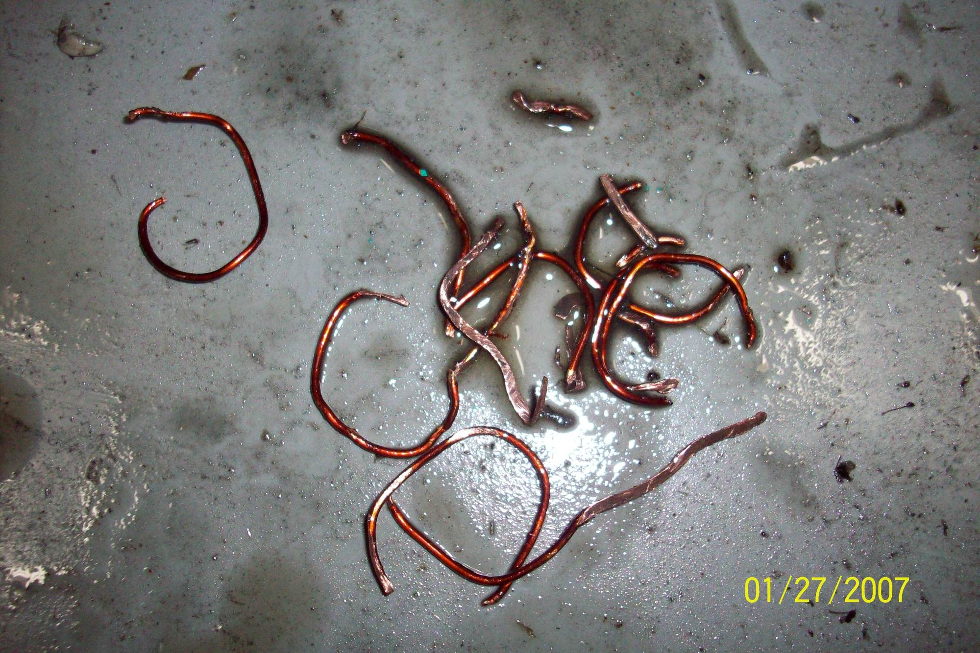

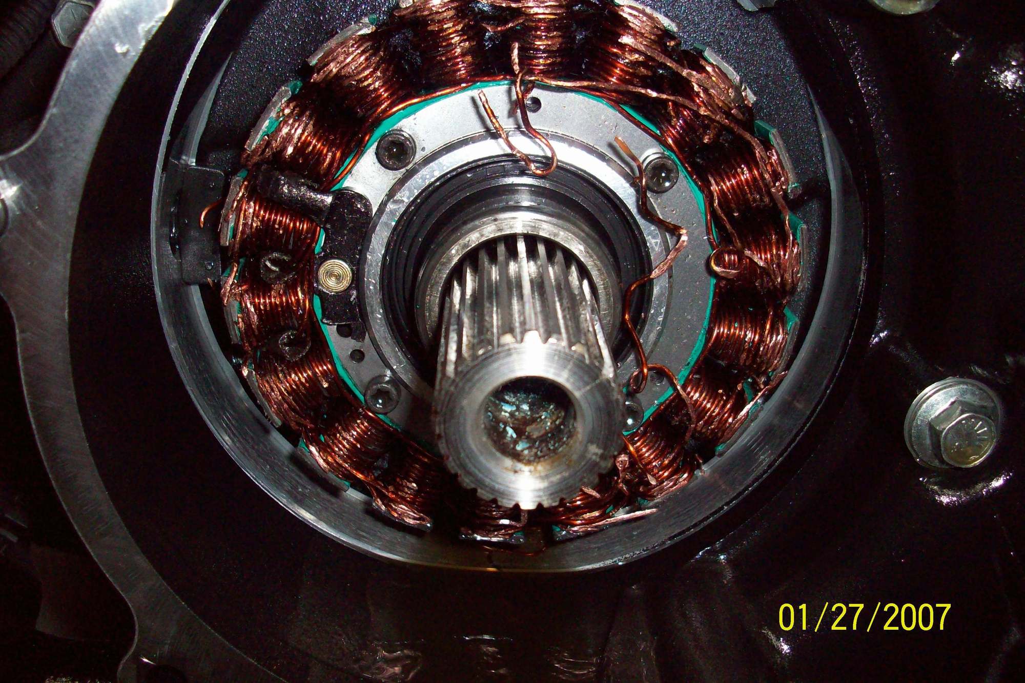

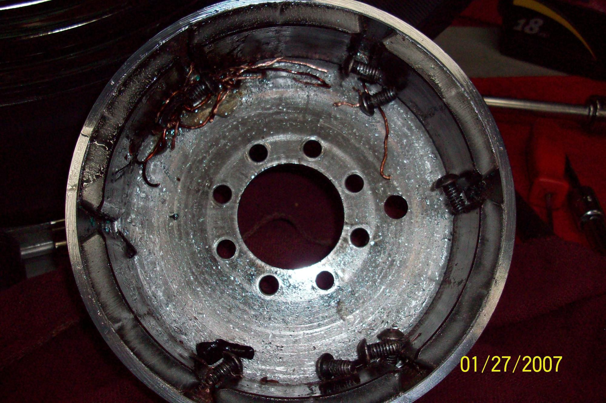

The 2006 years (at least the FX models...ask me how I know)...had a poor initial design on the stator. Stopped tack welding the mounting bolts behind it, so the bolts would back out slowly..and start interfering with the stator..causing copper pasta to get all over your primary.
Recommend you use an '07 or newer stator type instead..when it's replaced.
Here's a pic of mine, from my '06 FXDBI
