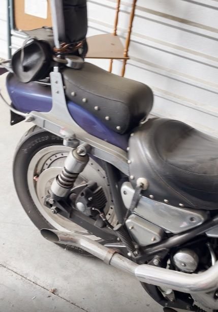

Here is a couple screen grabs from the vid the OP posted. It is an Evo FXR of some sort. I hd a 91 FXRS Low Rider Convertible but it had several differences.

1984 and 1985 are always a but harder to get the correct parts. If the common Harley oil filter on the shelf by the oil at the Harley Dealer doesn't fit, try Harley part number 63810-80A, which is Metric thread. They look the same other than the threads.
