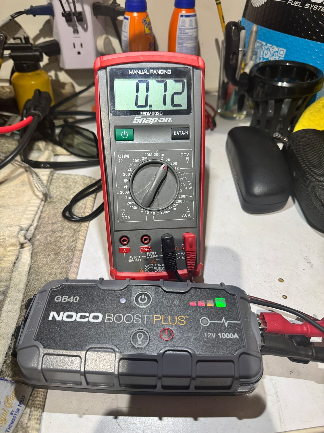

Have you ever measured the output voltage? I have 2 of these and they both measure the same. Very strange, measures less than 1 volt. Anyone know why I would get these readings on the 12v output connection?

It needs to see a load. It will not just put out 12 volts to air. Some have a setting for completely bad battery. But many will not try if the battery is complete junk.

Push the exclamation button and it will turn on the power. It is typically used for when a battery is totally flat.

Its an active system that needs to see a load, no load, no activation.
Connect to a battery and see what it does.
Read the instruction manual.
That's the boost button, and it didn't occur to me to press that but it did put out over 12v when I pressed it. Thanks for that info. All good I guess.

Try putting on decent battery without pushing the button.
