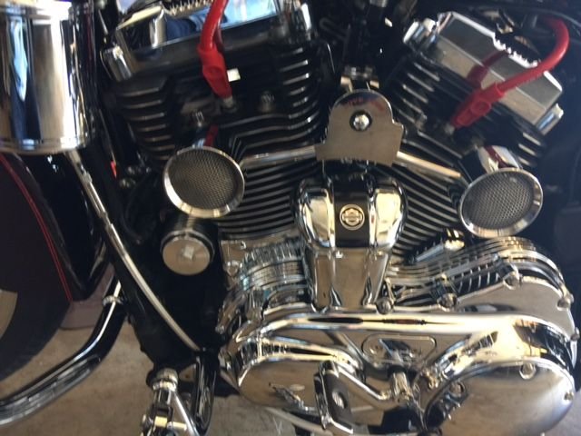

Just wanted to share my new horn using the same custom bracket for the fan.
For those curious about how loud the horn is, here is a vid of the horn..

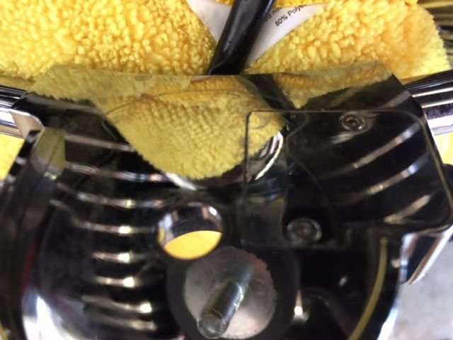

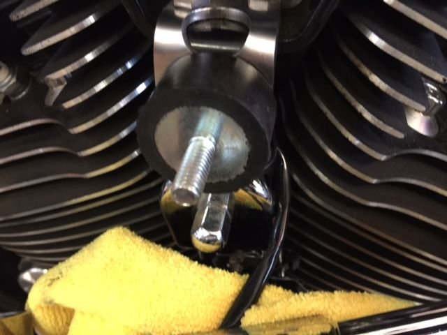

Done replacing the switch today. Simple task. Remove fan from mounting bracket, unscrew 2 allen screws on back, remove back plate, pull connector to switch, unscrew switch, replace switch, screw switch, plug connector, replace backplate, screw in allen screws, re-install fan on mounting bracket. Works perfectly...great repair service by Dave at Love Jugs. Although when unscrewing the two allen screws, one of them was stripped or the hole was too large i.e. would not screw in or unscrew, just spinned....good thing the other screw was functional and could tighten to close the back plate.
Here are some pics:

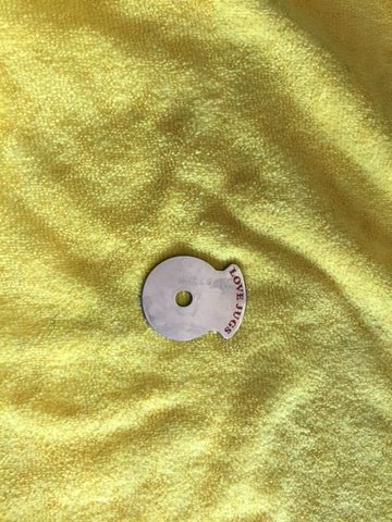

Had to remove this advertisement washer...sorry LG, not aesthetically pleasing, but the fan itself still prominently displays the LJ name.
Here are some pics:
