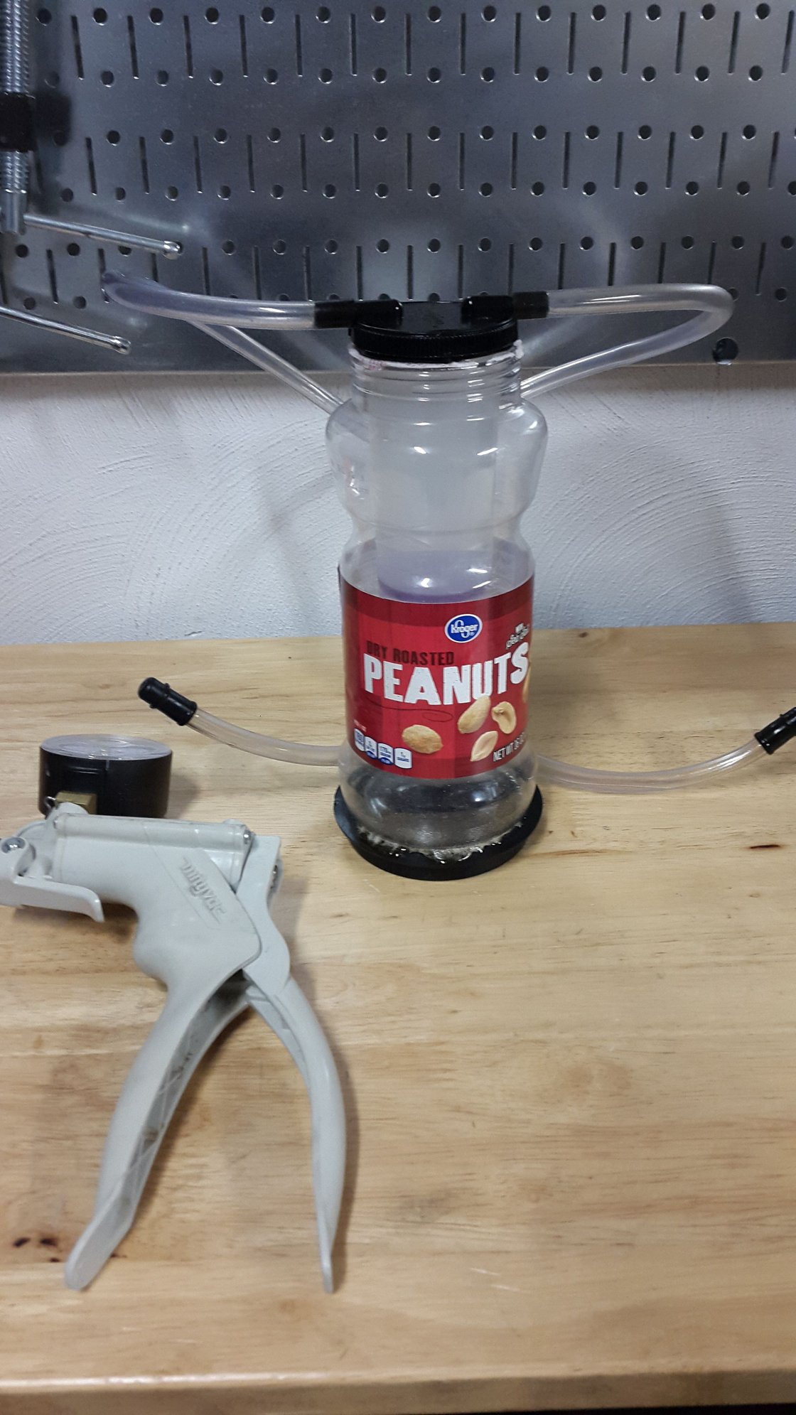

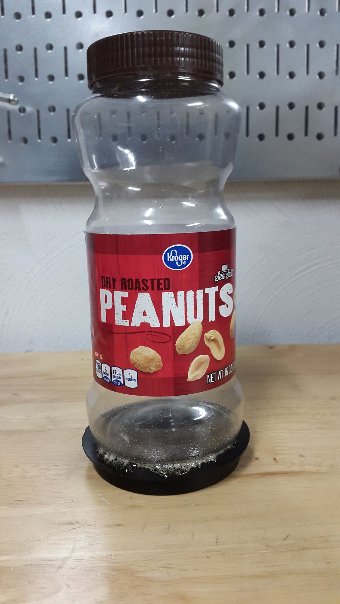

I made this to help with brake bleeding. It's a plastic peanut jar with a rubber coated magnet Gorilla glued to the bottom. I got the magnet off a free parts tray/holder from Harbor Freight (with a coupon).
I can use it by itself and gravity bleed directly into it, or I can set the Mity Vac reservoir down in it so I don't spill fluid everywhere. The magnet sticks to my table lift but it's also heavy enough that if you just set it on the floor it'll stay upright because of the weight. With all that's going on (ABS Recall), it can't hurt to make the chore a little easier.

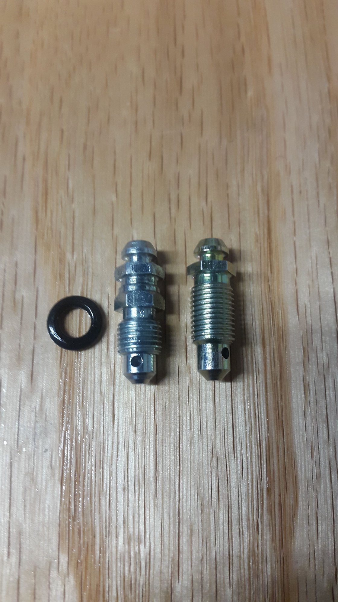

On another note about old brake calipers, well the 4 piston pre Brembos anyway. Look up that pic and the anti rattle clips he has there; every one I've ever taken apart have those exact ones.
I bought a new replacement caliper from Boardtracker a few years ago (it was re-built yesterday) and the anti-rattle clip is different, not directional with a leg on one side and a dent on the other. The other thing was the bleeder bolt had an O ring on it. I've never seen either of these things and have taken a number of these apart; not the same ones over and over
What gives?

Well, those calipers are up to a "C" Rev on the Right and a "D" Rev on the Left which includes a "B" Rev anti-rattle clip and a "A" Rev Bleeder
That must be some of the changes
Multi and Max,
Have a look at this bleeder that came out of my right front (newer caliper). It wept fluid after I re-installed it; couldn't get it to stop leaking. I had some NOS bleeders on hand and swapped it out. I read somewhere, that the o-ring bleeder is something used in manufacturing/testing. I don't know how it didn't leak the past two years (DOT 5 so I don't change yearly). If I have the mechanics right, the tip of the bleeder screw protrudes into the hole in the caliper (at the bottom of the threaded hole). The o-ring bleeder never would have made it that far.
What gives?

I would think that it had to seal as it didn't leak before you took it a part.. Maybe the O ring swelled up a little during cleaning? I hate the stock bleeders. Hex part is too narrow and the bleeder nipple too short. I'm good at making messes when the bleed hose pops off.. I ended up making my own bleeders..
