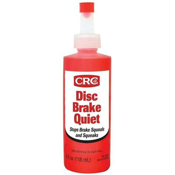

Old May 3, 2023 | 09:11 PM
ChetB's Avatar
ChetB
Joined: Nov 2009
Posts: 771
Likes: 572
From: Northern Lower Mi.
Old May 10, 2023 | 05:12 PM
Rodent66's Avatar
Rodent66
Joined: Apr 2021
Posts: 273
Likes: 86
From: S.Texas
Never had any EBC pads squeal, and I’ve replaced many on different bikes. But I did have a sidecar rig that the front disc w/OEM pads squealed really bad. The CRC disc brake quiet ( like chetB posted) fixed that ( applies to back side of pads). Silicon rubber may work same dunno.
