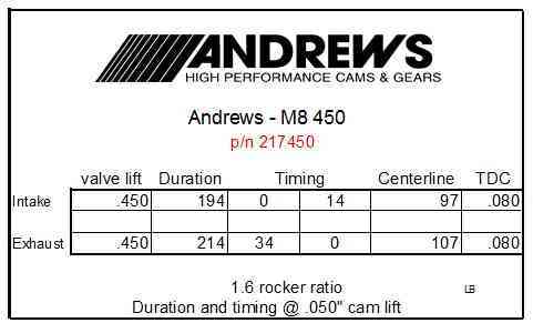

Default New M8 Cams from Andrews.
I saw these cams with dyno runs at the Expo.. I didn't pick up the data sheets at the time but Gary at Andrews just sent me the specs.. IIRC the dyno run showed a significant increase evenly across the whole power band on the 450.. It was better on the low end compared to the SE cam but not as good up top. The 450 is available now but the 460 might see a change before release.. They are also releasing some higher performance cams for bore kits with higher compression.
MSRP is $187
Ready for sale.
Preliminary
