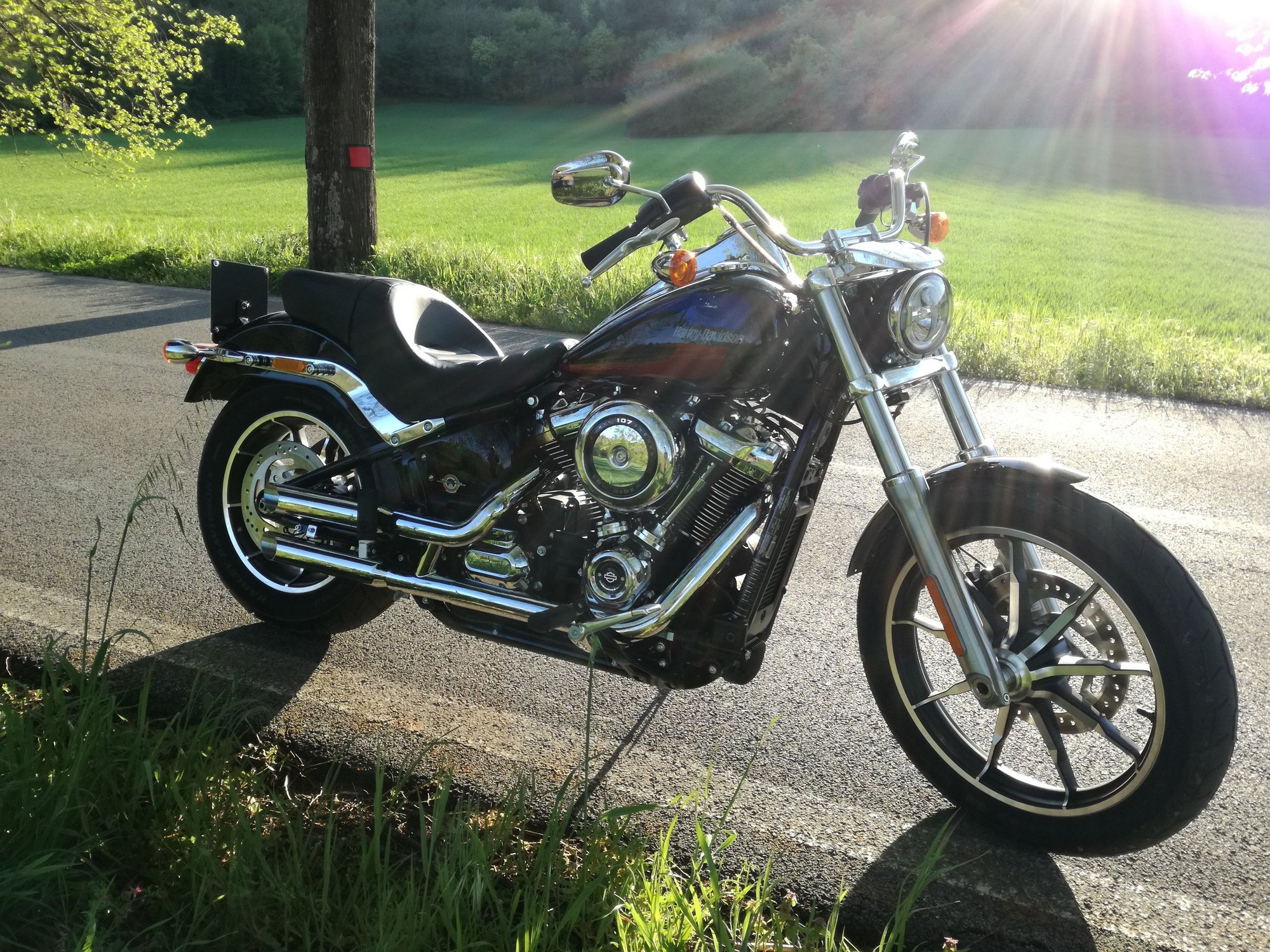

Ciao Enrico,
The connection pipe is allowing each burst to flow out of both mufflers making the exhaust path more equal and less restrictive. I would not block it. I was in bologna last year, I love your country! Many Ducati and Harley riders plus excellent food and Cafe! I also have the 2018 Low Rider and it does similar sound you say. I think it is cam timing and small exhaust valves. I have picture of mine, show us picture of your bike in Italy! Ciao!

Hi !! The next time you come to Italy, please come to me. I will gladly welcome you. We can eat excellent Florentine steaks together! About the discharge compensator I think you're right especially with the original exhausts that have less flow capacity. But with open mufflers in my opinion its function is very limited and probably does not contribute to have a better sound.
Very nice your little windscreen can you tell me the brand? Are your exhausts factory-made?

The windscreen is from Dart in the UK. I modified the stock exhaust myself. I left the catalytic converter in place but removed the restrictive baffle and replaced it with approx 2" louvered baffle. I then machined somes aluminum end caps to hold it all together.
