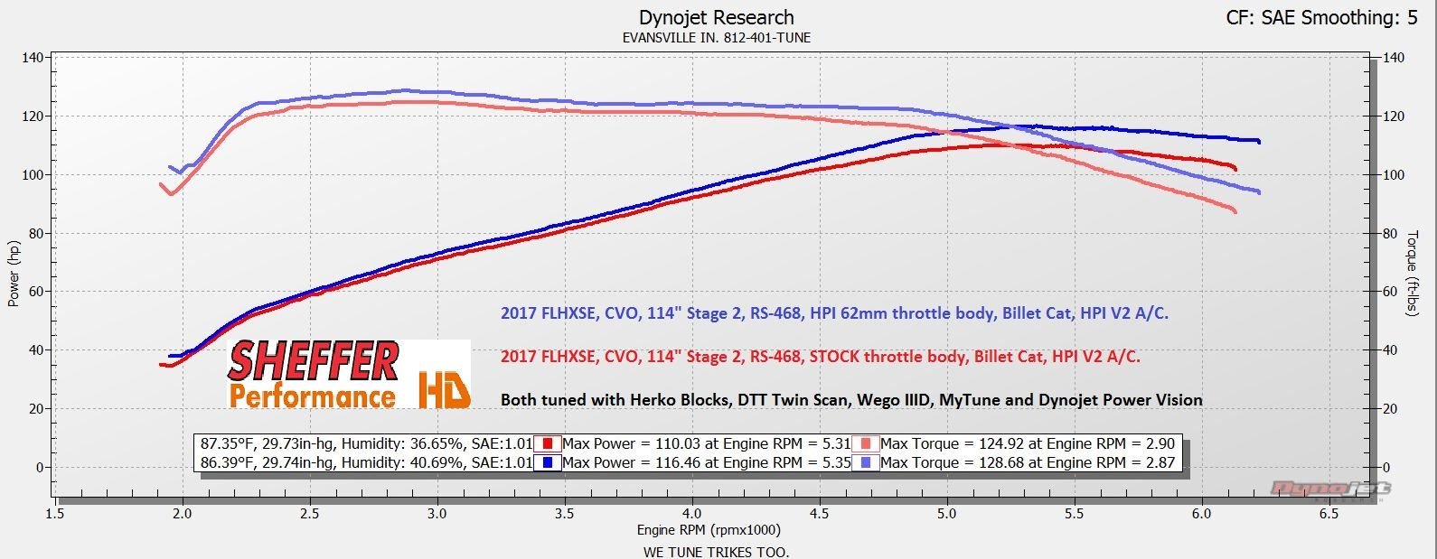

The RS 468 is a great cam and will work fine in your application as long as the tuning tech knows what he's doing and uses a good flash tuner, PV, TTS, DL.
Here is a CVO 114 stage 2 that we did with the 468 and it did well...As a bonus you can see what adding a 62 mm HPI did for it. The added compression of your build will make it a touch better.
