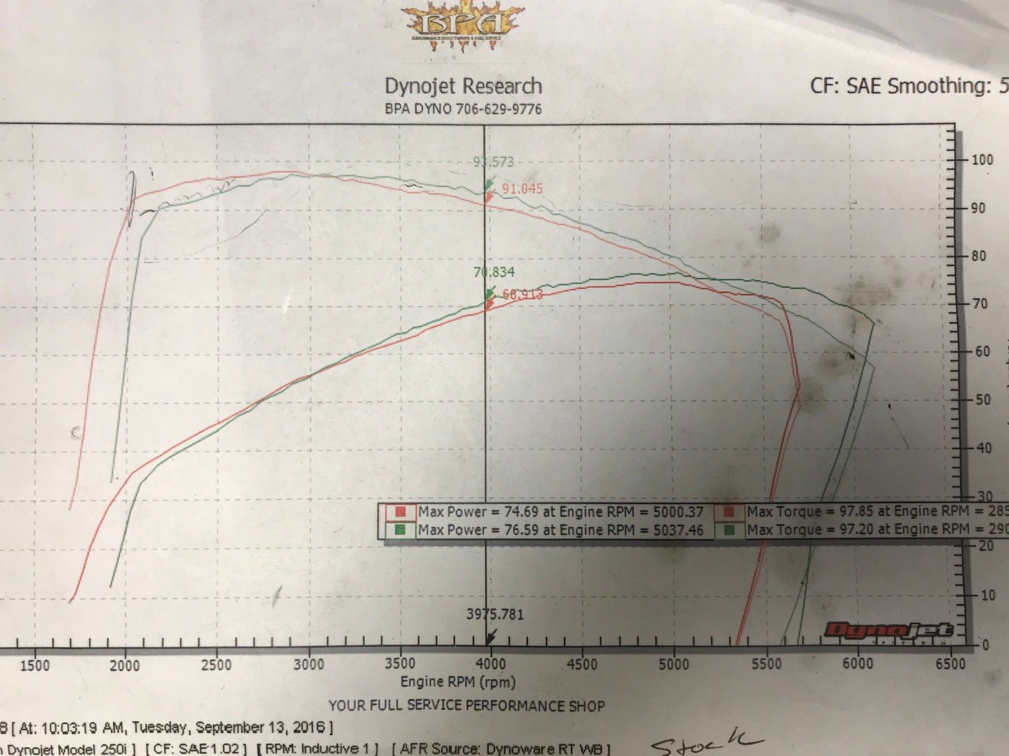

(NOT my bike) Stock 2017 107” as delivered vs same bike with S&S MK45s, SE Heavy Breather, and unlocked ECM. I found this map at the shop I’m using to tune my bike. I’m including this one not only for those wanting a baseline vs Stage 1, but also to compare to my Stage 1 (main difference being the power vision and Fuel Moto’s base map). This showcases the increase you can expect from fuel Moto’s base map.
This is my 4th gear & 5h heat pulls with no tuning other than Fuel Moto base map.
You cannot even begin to compare those two charts. Different bikes and one report in SAE and the other in STD! If the STD runs were in SAE you would expect to lose about 3-5 HP and 5-6 Torque on average.

This is my SAE chart, for reference. Yes Steve, as I stated, the other bike’s Dyno is, in fact, a different bike. I prefaced that with the intent to encourage that the two Dyno’s are definitely not an apples to apples comparison. However, just throwing that other Dyno in there as bonus info while I’m documenting my real comparison between my baseline and my 117”.
So now that you posted your SAE chart you can see the numbers are much closer to being the same as the other bike, even though they should not be compared as it was a different bike. One much compare apples to apples if you want to really know what's going on.
