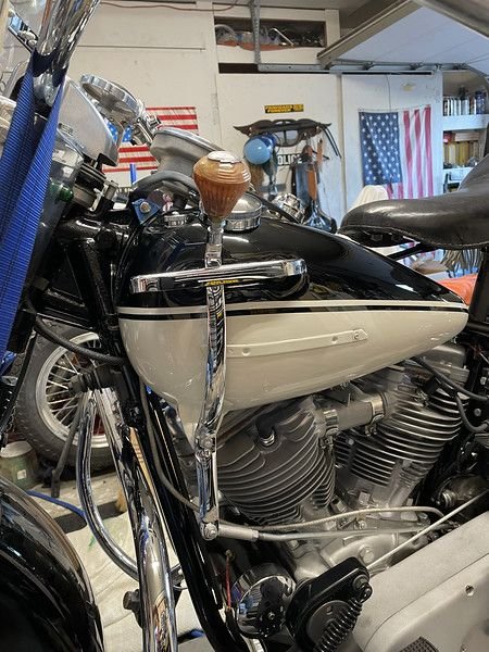

Finally some time to spend on the bike. Left side 3-1/2 gallon tank mounted, also shifter parts (3+R).
I have several different shift *****. Think the hardest part will be making sure that someone doesn't decide to walk off with the shift **** when I park it (which probably means eyes on the bike at all times),
Also just realized I never posted pics of the tranny rebuild. 3+R has a couiple of different parts, so that's coming as well.
Waiting on a crossover exhaust pipe (out for chrome) that I found that is in much better shape than my original. 2-4 weeks before it comes back tho.
Theoretically, the pipe comes back, gets mounted and mufflers assembled, the next step is gas line from tank to carb, battery, oil gas and supposedly ignition....but we shall see. And with just the left tank mounted I can keep a close look at the electrical as well as the engine components. Told the wife that I am going to vidoe the bike running for the first time in 20 years.
