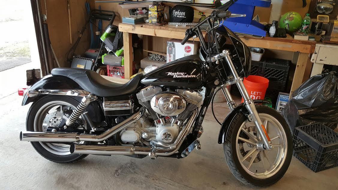

Well I had been throwing the idea of painting the motor on the dyna FXDI I love my bike but hated that blonde/gray that was all over my motor made everything look kinda cheap when my bike was sitting next to some bikes with blacked out motors, so I did a little researching and found the wrinkle black paint sold at the HD dealership and my bike turned out great, I am more than happy with it

And here is the before picture

That looks sick! I agree with you on the gray. Nothing better looking than black and chrome. Anxious to see how well it holds up for you. Nice job.

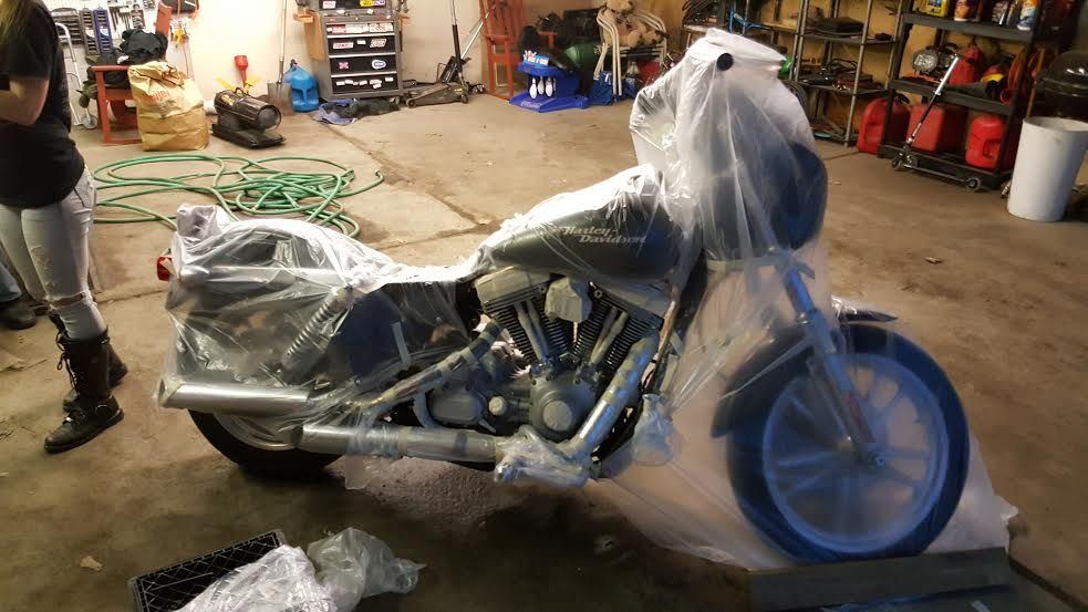

Looks good dude.Nice work.How did you go about it.Mask it off?

I pulled off a few things, a.c, heat shields, battery and box, mid controls, and the horn everything else I plasticed and taped off here is a pic before the ol lady even got involved she did a hell of a job taping off around the push rods

Took about 2 days, day 1 i got everything takin apart, taped off and laid some paint then I let it dry over night and sprayed an additional 2 coats along with a texture coat the 2nd day anyone that hates the gray look of their bike I would recommend doing this if you take the time and have the ambition id say do it overall only cost me 22.50 for paint and anther 7$ for the tape and plastic
