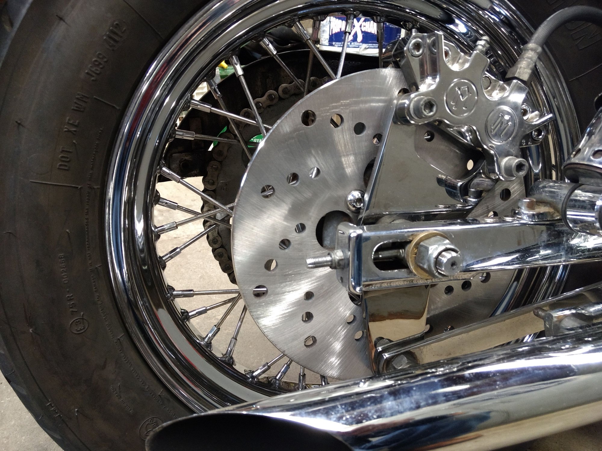

Over the last couple weeks I've been ordering parts to upgrade a few things...
I've been having an issue with my ignition. After idling for a minute it would pop out the exhaust and stall as if the ignition fired prematurely. It was an old Compu-fire system with centrifugal advance that really didn't work all that well...
So I brought out of hiding my old Screaming Eagle ignition that I had on my Evo. I Needed to make a harness to adapt the 8 pin Duestch connector to a (Standard Electric) Hall effect cam position sensor. For the sensor connector I had an extra 3 pin Duestch connector that I got when I had my Dakota Digital speedometer for the Evo replaced under warranty. I found a female 8 pin Duestch connector online and some pins and found all the right color wiring laying in the tool box. So put that all together last night to save me a little time today... I should have taken some pics of the harness.. Sorry...... Maybe I can get some tomorrow... I also picked up a new ignition rotor cup from a friend.... I also set it up for dual fire.... Runs awesome....
I also ordered a new rear brake rotor and pads... They weren't working worth ****.... EBC Kevlar organic pads. Love them, I also have then on my Evo and they work great. I also like the fact that they were only $22... Never did a rotor on a old Superglide and I was a bit surprised that the back side of the rotor's button head socket screws had nuts and lock washers on them.. not used to that... I got rid of the nuts and lock washers and replaced them with ny-lock nuts... I thought that would be more reliable... It Didn't take long at all to swap out the pads and rotors Thanx to the axle nut being on the rotor side.....
While I was doing the ignition I also cleaned up the wiring on top of the oil tank ( I'll add some pics of that tomorrow) and I installed new rubber isolators for the battery mounts.....
Even though it rained most of the day and I couldn't test ride it, it was still a great day.....

Here's the pics I said I would post...
Here's where I cleaned up the excess wiring..
The new Cam position sensor...
And the new brake rotor and pads.....
