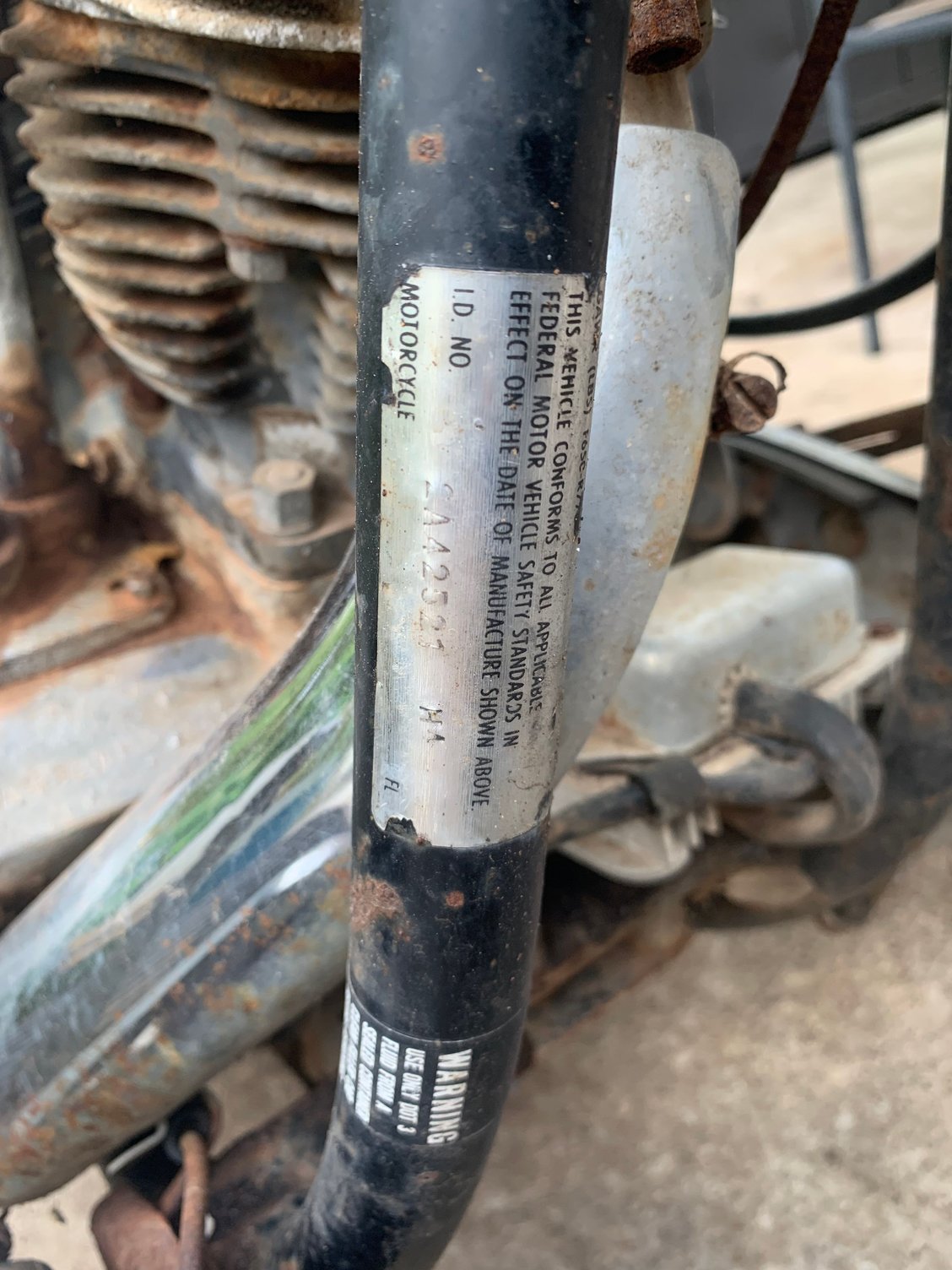

So I believe this matches the number on the sticker

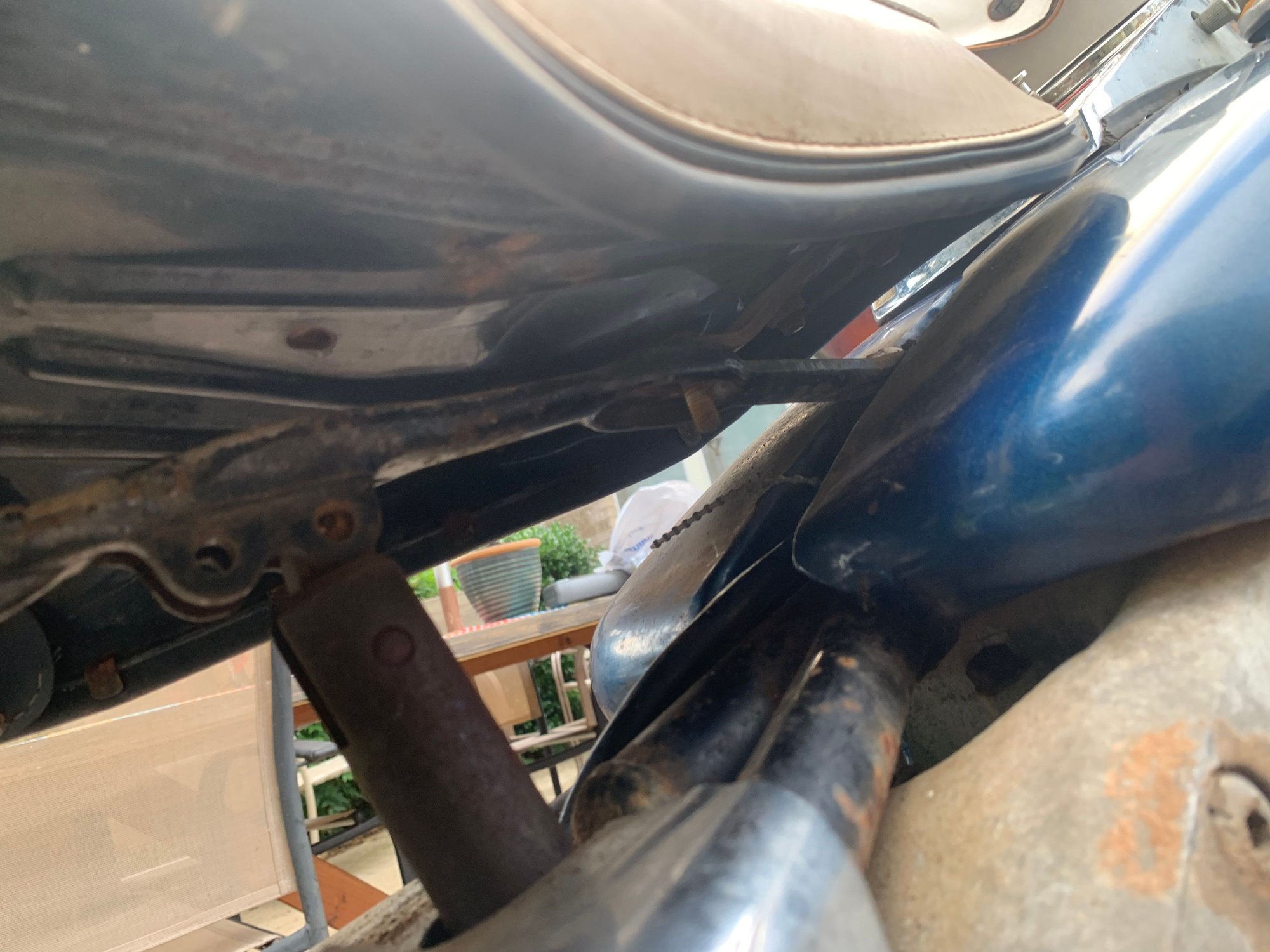

Not sure if I’m missing something here I’ve removed the pin but still haven’t got the seat to move more than like 1 cm
Not sure how to go about getting that off either

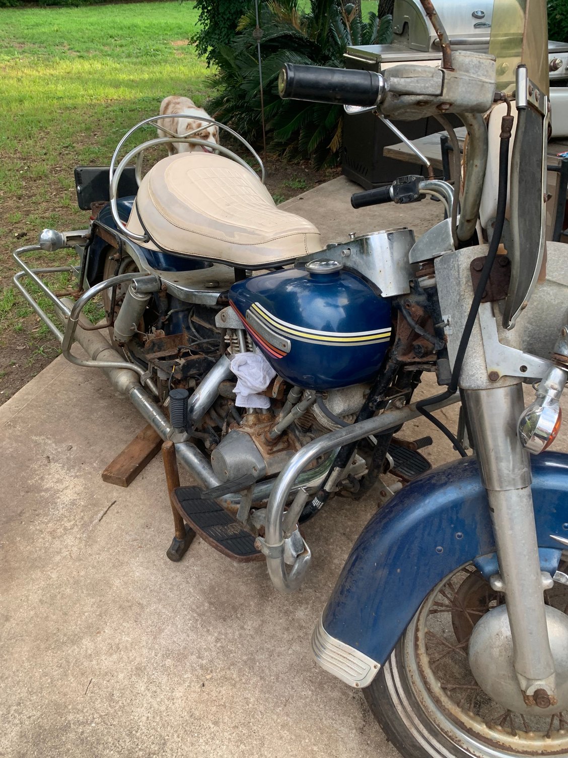

Took some pictures this morning if that helps.

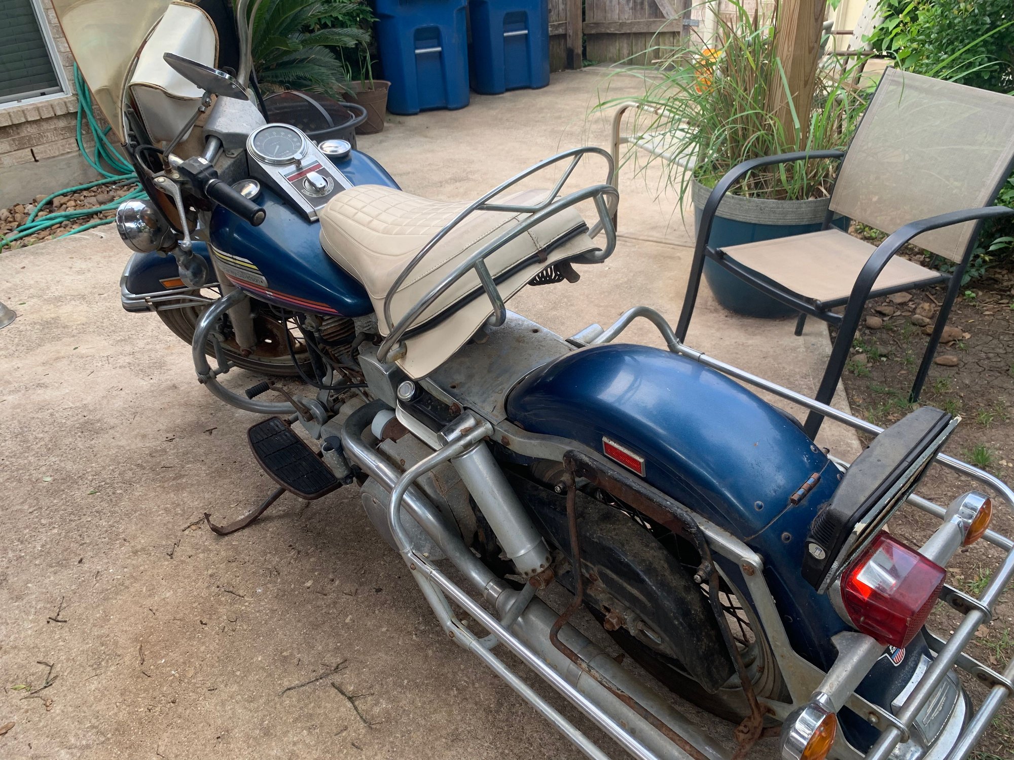

Now that is helpful....you have a 1974 FLH Electra Glide...with matching numbers.

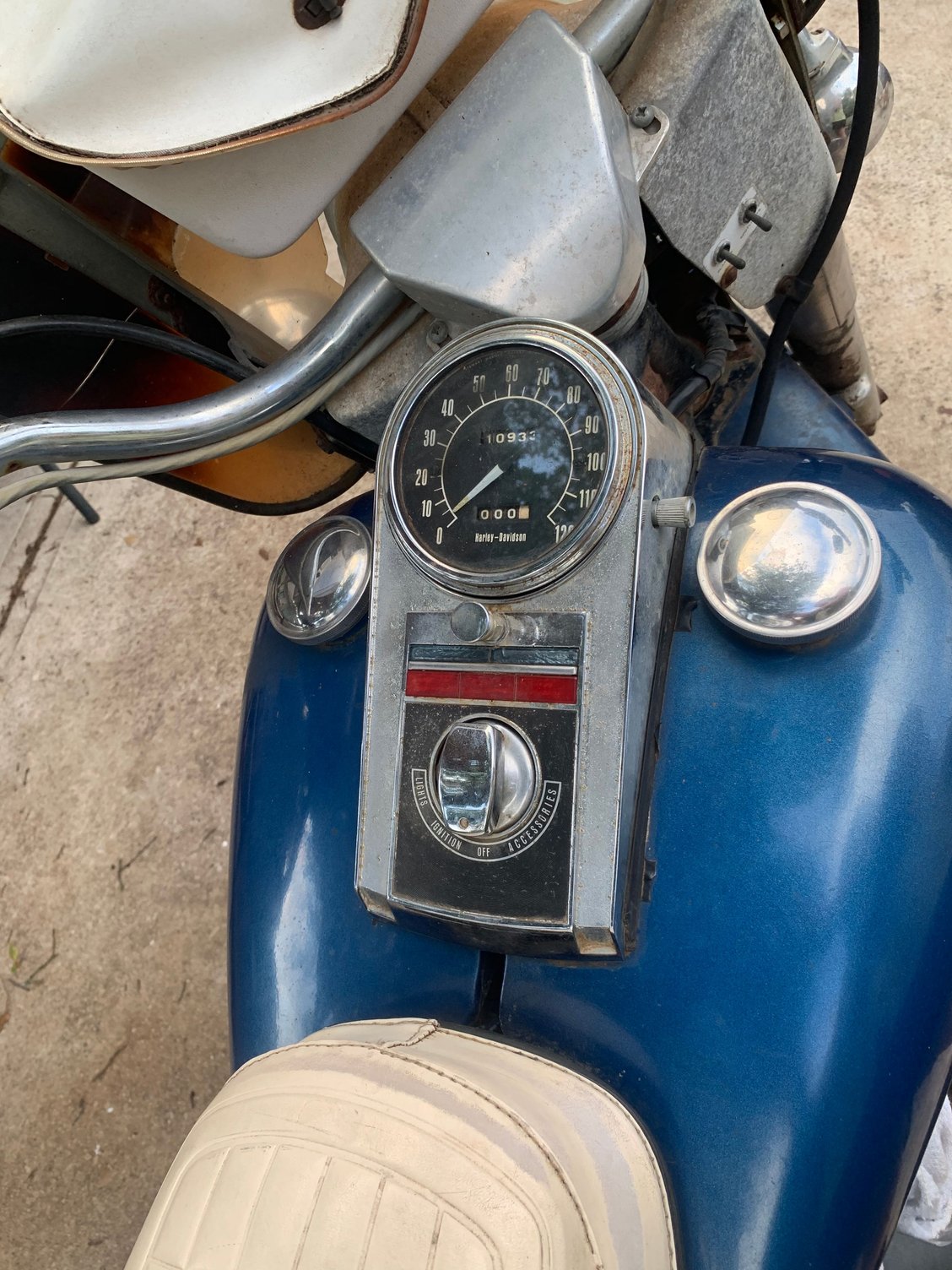

For the dash, there is a screw securing the trip ****....unscrew and remove the trip **** and unscrew the nut under the choke...then the dash can be lifted up off the tank.
For your seat, if you removed the clip and the pin and it doesn't lift up, it may be rusted so try spraying some lubricant at the front of the seat bar where the bolt is and where the seat sits on the post where you took out the pin.
Your grandfather's bike looks like an unmolested piece of history...have fun with the restoration.

See the little knobb that Ya turn to set the odometer back to all zeros? it has a little Phillips screw in the center.
Take the screw out then the knobb slides off. Her choke knobb just might have a set screw in it also..look and see.(one side or the other)
Then its time to get the nut off the choke..this allows You to slide Her dash off..leaving the speedo and ignition switch in place.
