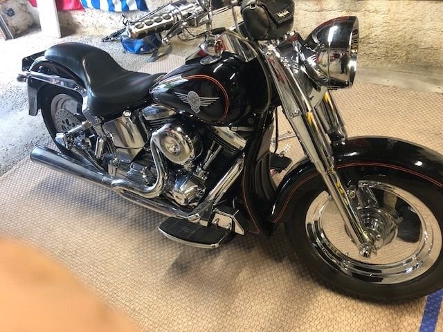

Y'all have been so great!
Thank you so much! I really appreciate all your replies....
Looks like I have a bit of work to do in the next few weeks......but I'll definitely keep you guys posted!

Looks good. I have a 1996 Fatboy that has never sat a year sense it was new still going strong. However it has never been touch by bubba the half *** indy. There are some darn good EVO indys around but you really need to do you homework before letting them touch it.
Read up on cleaning the Tappet screen. If you have trouble find information yell most here can explain it.
