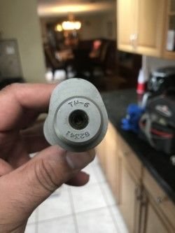

Woods Cams are in a league of there own, hold one, feel the quality, and you see why you pay more, they include that bearing as well, for cachets....I have a cam install kit coming with the 2 Torrington's and I opted for the Woods Directional Lifters, from Woods Site ::The NEW Alpha Series lifters incorporate the new EDM technology,
a patented pressurized oil system. In these new lifters, both sides of the
lifter bearings are pressure fed by two oil ports spraying oil directly
on the needle bearings. We have also incorporated and updated the oil feed system that provides <br/>oil to the top end and rocker arms 25% faster with 10% more oil. . . <br/>many other new features for bleed rate and lifter fill times are also <br/>built into the new

It's gonna be sweet!! I'm curious what made you go with the TW 6-6? It's specs are very similar to the Andrews 37H cams I have in my Breakout, which, like the TW6-6 is a mild 510 lift cam, with an intake close at 38 vs.40 on the 6-6, and it doesn't really come on until around 3k RPMs. With the intake close at 40, the 6-6 should come on even a little later then the 37H, and I thought you wanted a cam with the peak torque down in the low/mid range....Just wondering why you went the other way??
