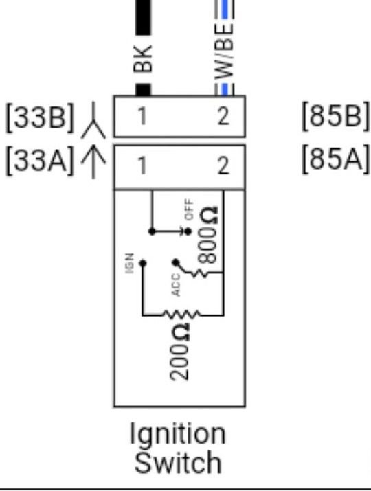

it could be that the switch changes the resistance in the circuit and the ECM reacts to that change in resistance (this is also how some steering column switches work, or so I am told). This way the switch controls different items depending on the voltage sent to the ECm port. UNlikely it will therefore be possible to do, unless the ECM can be modified/replaced
Correct. The resistance changes, depending on which position the switch is rotated to.
