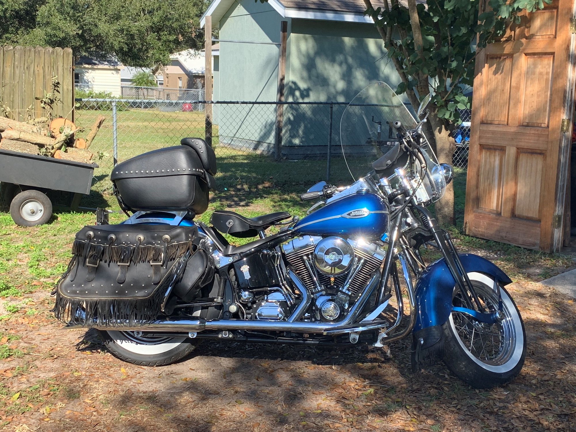

I'm doing the same thing for my Springer. Say what you will, but I just went to Amazon and ordered the mount I wanted. Was a lot easier than trying to make something work and it's a lot cheaper (okay, use that word however you will) than what H-D offers.
Amazon Amazon
This one is for solo rides, but there are also ones for two-up as well. For $50, I figure it'll work just fine. Hope it helps!

Just finished the install with the mount I highlighted. It's definitely not an H-D mount. Took a little bit of tweaking to get it to fit. I found out that when you bolt down the tour pack, it tugs the upper part up just a shade. That made the front mounts a little narrow. A slight tweak while the tour pack was on and it fit perfectly with no fuss!

Looks good

I do like that..............
