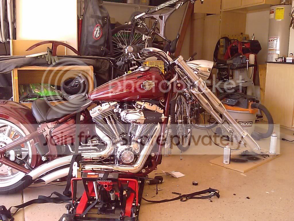

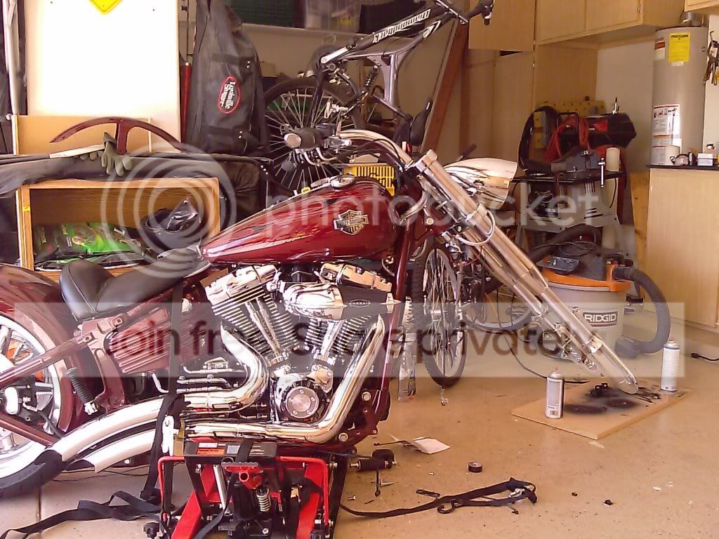

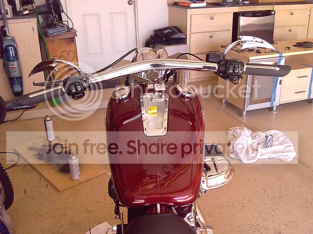

Im at a junction on the road and really having a difficult time trying to figure out which way to go.. I have replaced the front end which has 5* rake and new bars Carlini 9" 1.5 super sweeps, I like the look however with the front end raked my speedo on the tank doesnt fit.. Now, change out bars (grrr), new tank or move the speedo guage... This has been one heck of a learning experience... Let me know what would be easier and if I do move the speedo how would I cover up the top part of the tank, if anyone knows of after market peice or would this be custom???? Still need to change out bearing on front wheel, awaiting for caliper.. I have ordered a 21 and new rear wheel however they are on back order and AZ bike week is 9 days...yikes

Maybe a spacer between the bars and the trees, depending how much clearance needed.

You can get spacers that'll raise your bars, or you can make them. Stainless steal shaft stock the same size as your bars with a hole drilled through and some longer bolts. Then use your own creativeness from there, maybe have the spacers oversized and turned and shaped instead of plane ol' round. Then S/S will polish to a mirror finish. Carfull that your cables will reach the extra few inches.

Both of you are right on! dam have to unsnap all of those wiring harness, but this is the most logical route.. I stared at it and other then going extreme thoughts the simple solutions eluded me.. Thanks To you and wallie
