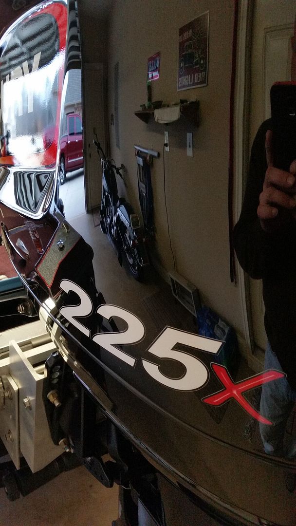

I'll reiterate the Maguire's Scratch X 2.0. It's a phenomenal product. I use it to take away swirls in the paint as well as the black plastic cowling on my boat motor.
This cowling had TONS of fine scratches on it from years of wiping it with towels... I used Scratch X 2.0 on it (by hand, NO circular motions, follow the contours of whatever you're working) and then followed up with Maguire's Carnuba Wax.

The 2.0 is definitely more abrasive (but not as abrasive as rubbing compound paste), it did exactly what I hoped it would do, which was remove the circular swirls in the paint left from using the wrong towels to dry it for years. The Swirl X will "fill" the swirls to mask them and maybe after 5-6 coats it may remove them. The Scratch X 2.0 will take them out in one coat, maybe two coats for stubborn areas (like around the gas cap).
