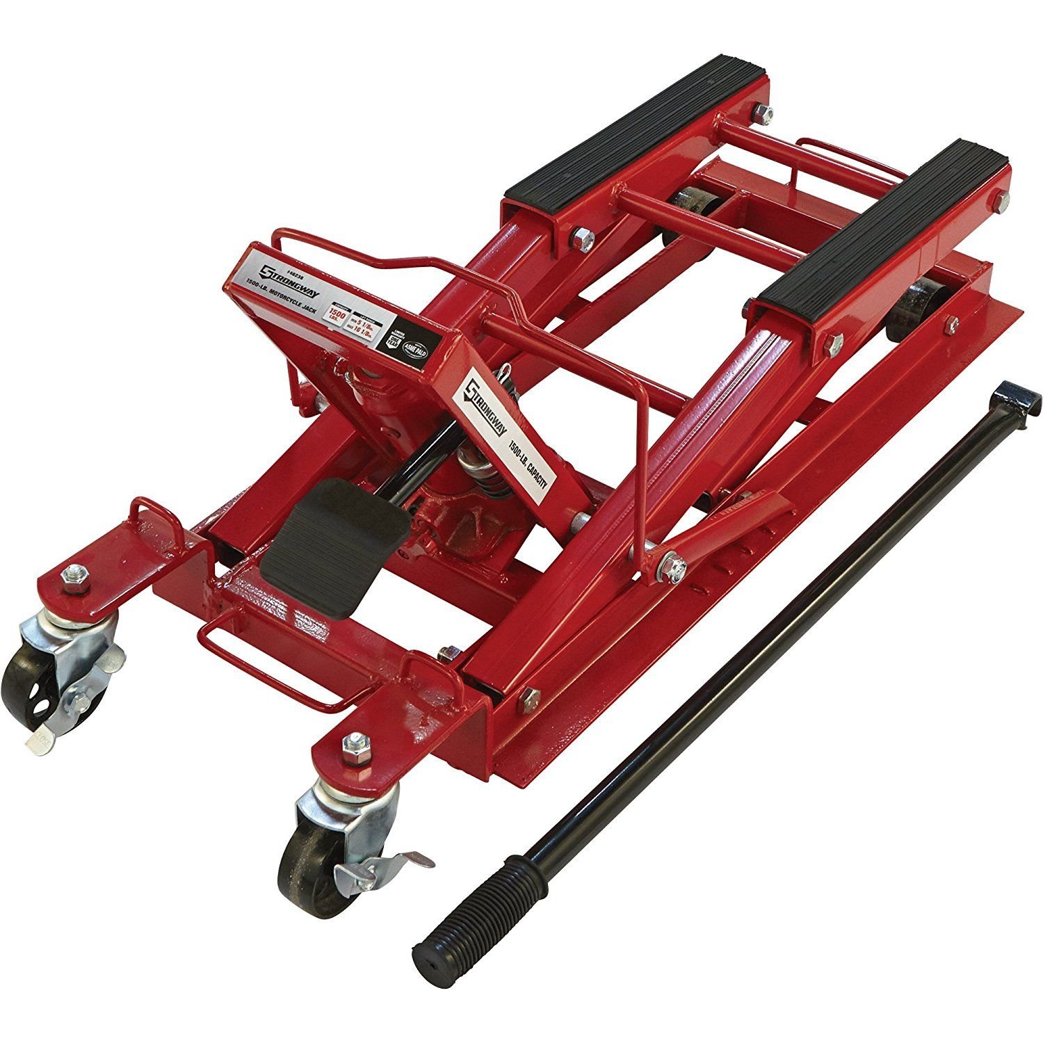

Old 09-15-2017, 11:56 PM
Hurricane 68's Avatar
Hurricane 68
Hurricane 68 is offline
Join Date: Nov 2016
Location: Sparks Nevada
Posts: 628
Received 112 Likes on 95 Posts
Default Lift table
only way to go and safe.

Old 09-16-2017, 12:05 AM
Hurricane 68
Join Date: Nov 2016
Posts: 628
Default Or use this for tire work
This. Comes in handy also

Old 09-16-2017, 12:12 AM
JesseDyna's Avatar
JesseDyna
JesseDyna is offline
Join Date: Dec 2015
Location: CA
Posts: 1,416
Received 312 Likes on 228 Posts
I used one of these jacks for my Sportster and it was very useful for a lot of things. You'll need to have the Good Lord in your life for good measure.
Old 09-16-2017, 04:41 AM
cvaria's Avatar
cvaria
cvaria is offline
Join Date: Sep 2012
Location: Tallahassee, Florida
Posts: 12,344
Received 2,189 Likes on 1,677 Posts
Originally Posted by John Harper
I've had my bike 27 years and have had no need to ever lift it for "maintenance." What are you trying to accomplish?
John
that's amazing... how do you get the tires off and service your frontend? (troll'n)
@OP a harbor freight 1500lb lift and some ratcheting straps will set you back about $80 with a hft coupon. Don't skip the straps... we don't like bouncing bikes. **** happens
easy peasy on a sportster... nightmare on bigger bikes.
floor jacks are there because i just dont like my bike hanging out like that over long periods of time
Old 09-16-2017, 11:12 PM
Hurricane 68
Join Date: Nov 2016
Posts: 628
Default Never an issue
use straps on the table lift on the floor jack never a problem leave on it for extended periods balance Great winter leave up off floor entire time Alls good. Ride Safe. Wild Bill
