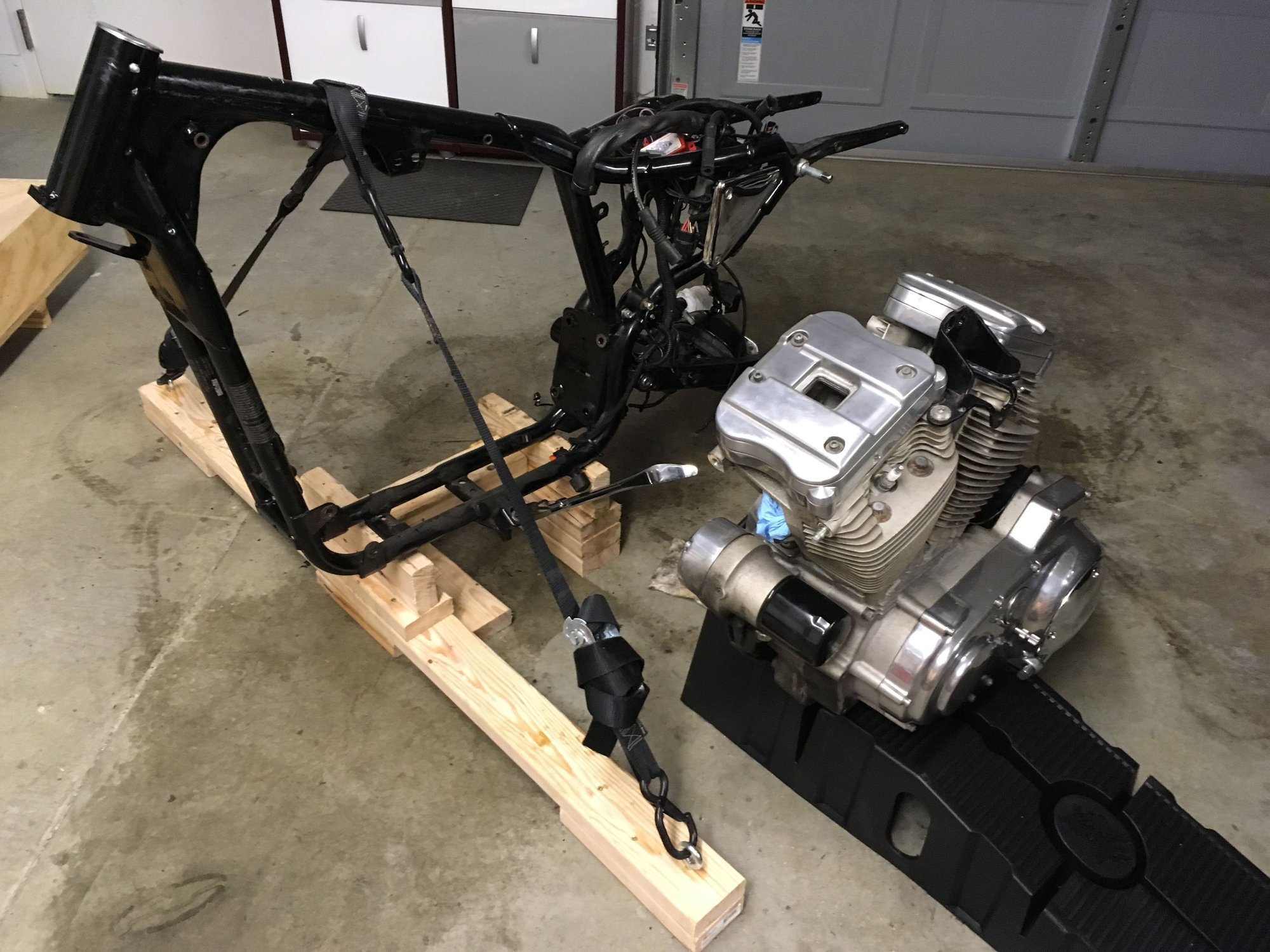

This is my winter project, Going to go for a hooligan build. 19" rear wheel Tracker bars and probably a tail kit from Phil Little.
So... If you had the bike stripped to this point would you keep going and pull the motor out of the frame?

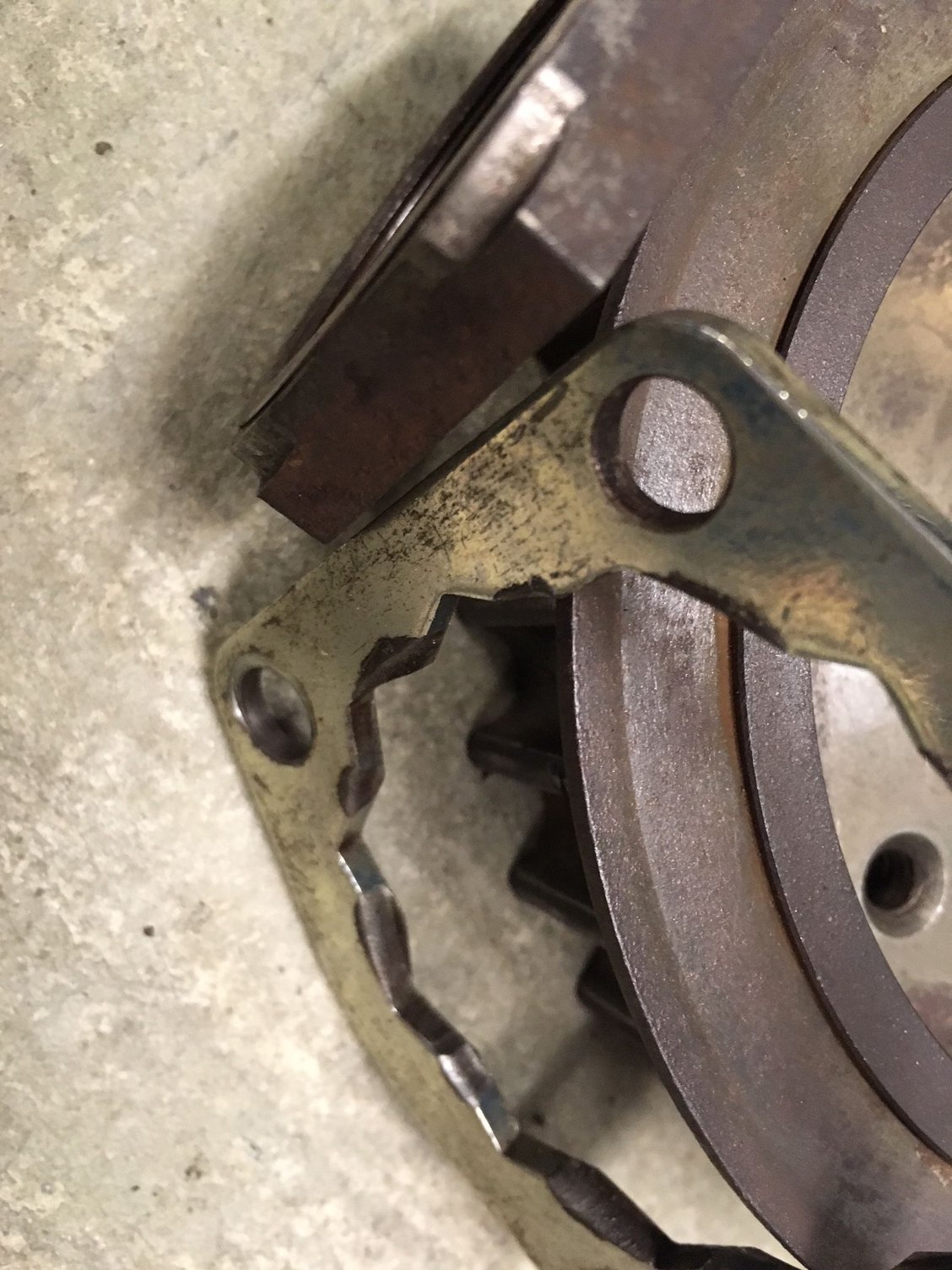

The transmission sprocket nut was loose and had spun around and rounded off the on the lock plate. The lock plate is DONE.
The main shaft and sprocket are still in great shape. Just lucky I guess.

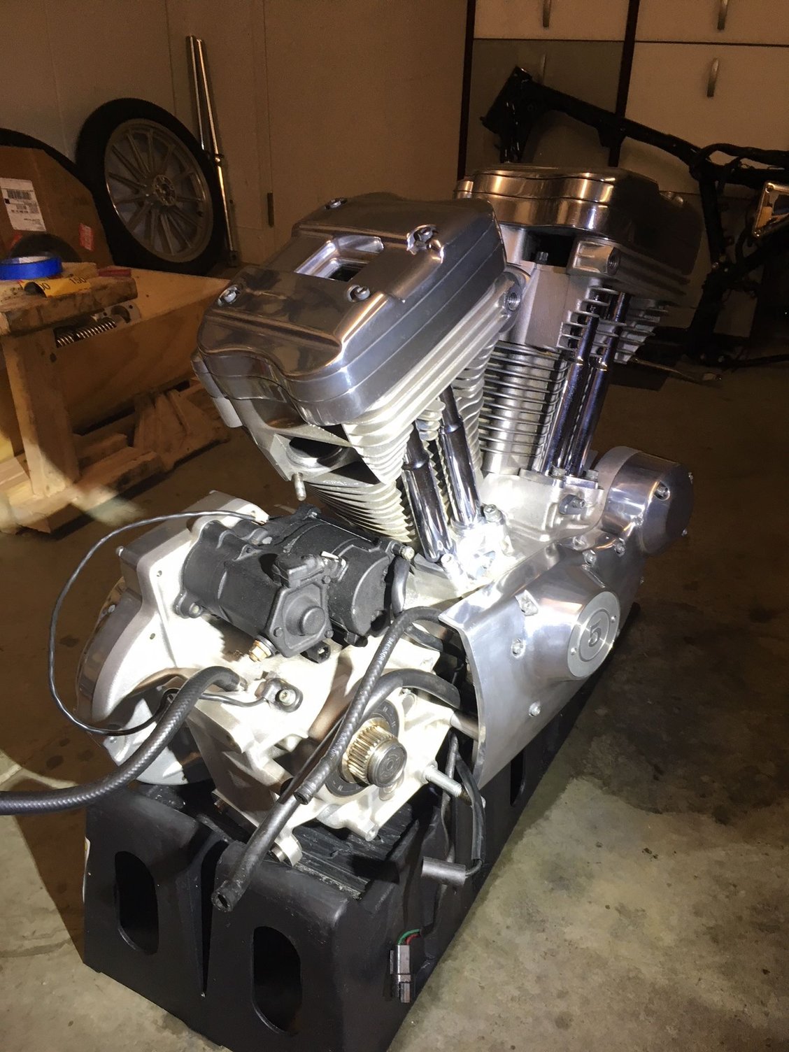

This is the condition of the case, jugs and heads. I was thinking about hitting them with cans of HD or VHT paint.
Good Idea? Bad Idea? Any other options the than pulling the whole thing apart and getting it powder coated?
I'm sure I will regret putting the engine back in the frame as is.

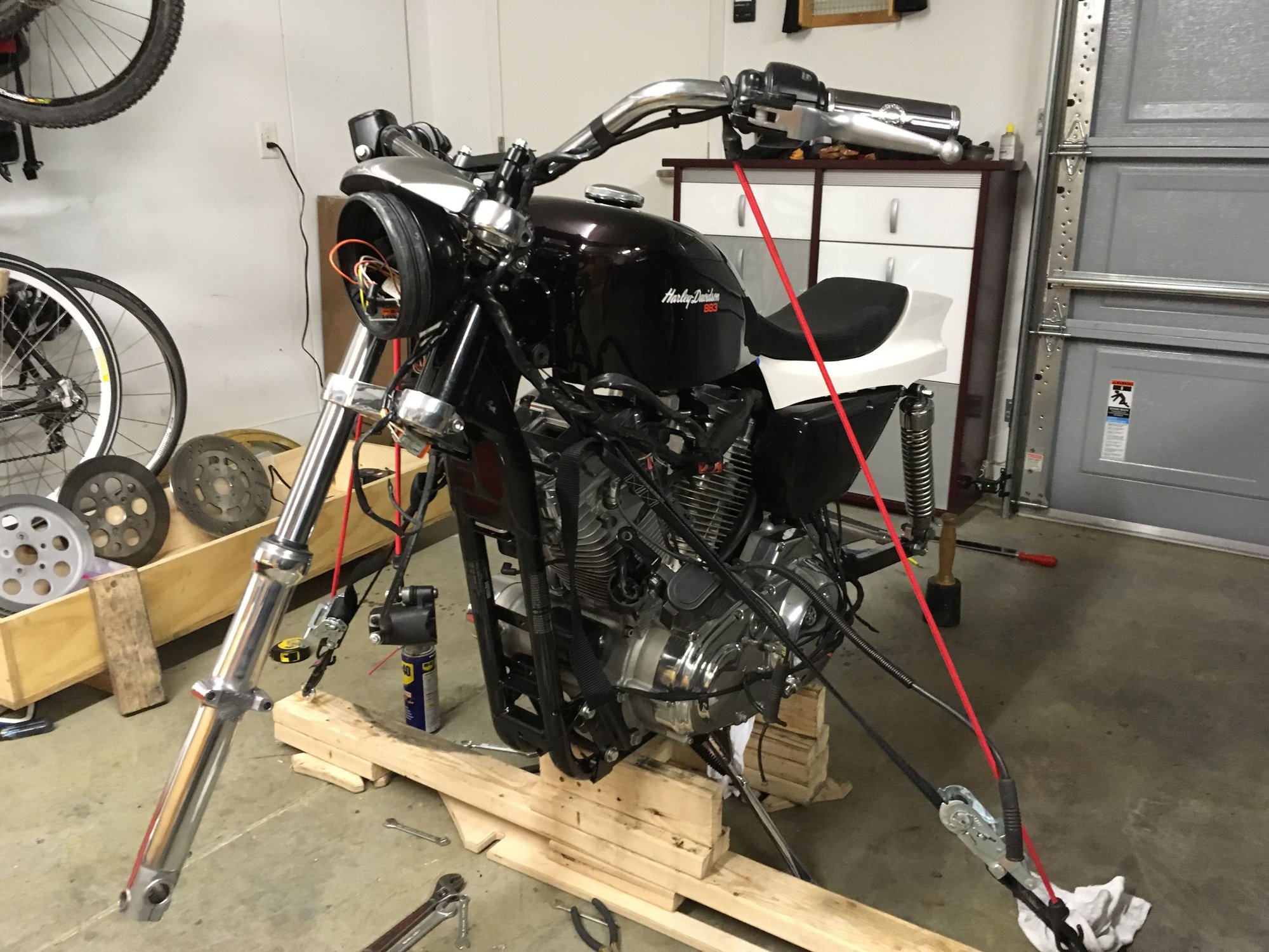

So all the parts have been cleaned up and I am now putting enough of the bike back together in order to measure up new cables and lines.
Everything is going to be replaced. I managed to find all the lines and cables I need in the right lengths. All braided stainless from Drag Specialists.
One Issue I had is finding a Clutch cable. The only matching cable I could find in the right length for the new Tracker Bars has 2 3/4 free play.
2 9/16 is the correct amount of free play. It's close enough I think... Unless someone thinks +3/16 is too much I will go with it.
Since I am going to be running the same 19" wheels front and back I will probably run the same tires as well. I really like the balanced look. I have and effective 14 1/2"
worth of shock in the back so clearing the diameter of the new hoops won't be a problem.
A matched set of Heidenau K34 4.00x19 tires should work great and look cool. Slightly over on the front and slightly under in the back.
The tires will help a lot with the tracker look and be good rubber for daily riding.
The braided stainless break lines front and back should help with cool as well as performance. I am going to go with a single length rear break line and use a brake switch banjo bolt. Should be an ez install.
The only setback I had yesterday is realizing that the used S&S Super E I bought came with an Eco intake and not a Sportster intake. There is another $100 in unexpected costs. Just add that to the list of them I guess.

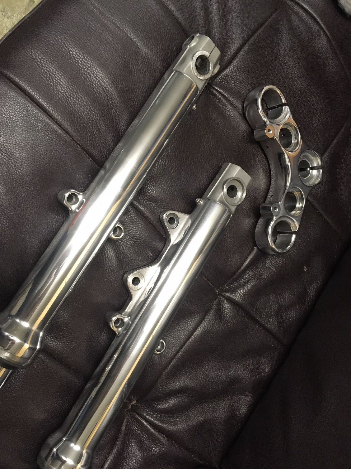

I found a 2000-2003 left fork slider and 4 piston caliper to make the 2000-2003 13 spoke wheel I have work. The hub was too wide to line the caliper up with the rotor.
Has any one else had to do this? Now I need to sand and polish up another slider to match. Not and EZ job when your only power tool is a cordless drill.
