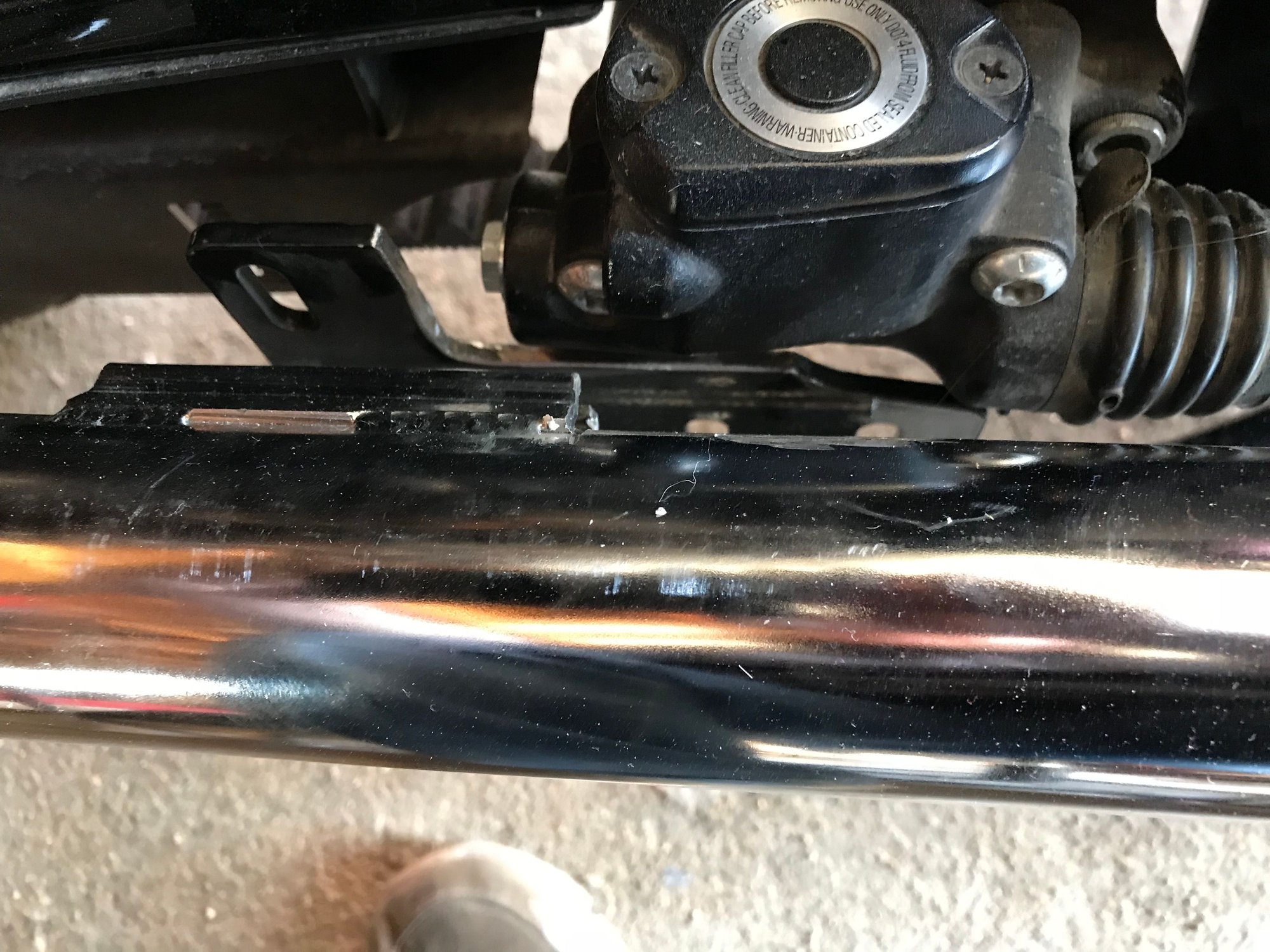

The rear brake master was in the way so I cut it out. Who needs brakes anyway. Kidding. The plate needed to be cut to clear the brake master resivoir so I chopped the upper forward mount hole off enough to clear the resivori about 1/4 to 3/8 of an inch. You can see the bracket on the ground here.
Here you can see the mock up. The bracket just clears the resivoir. I also had to cut part of the mount on the pipe itself. Very easy, BUB TIG welded the bracket on in three places so I just ground down the forward TIG welds and popped off the first two inches of the bracket. It’s no use anyway due to the mount being cut, there is no where to put a bolt through except the rear mount hole. All this is for the top pipe (rear cylinder)

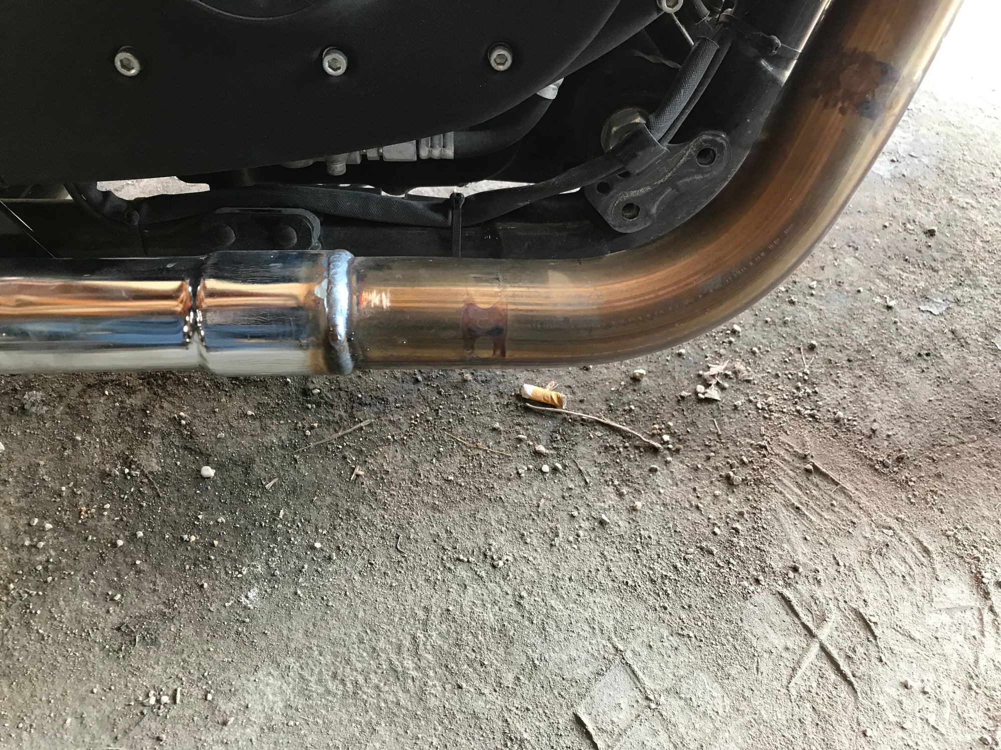

Once I removed the forward controls I mounted the bottom pipe (forward cylinder) and marked where the BUB pipe begins it’s bent up. The I cut the stock pipes small cross pipe and filled the hole. Marked exactly where I would need to join the two in order to keep the length the same as the upper pipe and welded the two together. Once that was done I mounted everything up. The lower mount bracket was too far in to I gave her some heat and bent it up to give me an extra 1/2 inch to clear everything
