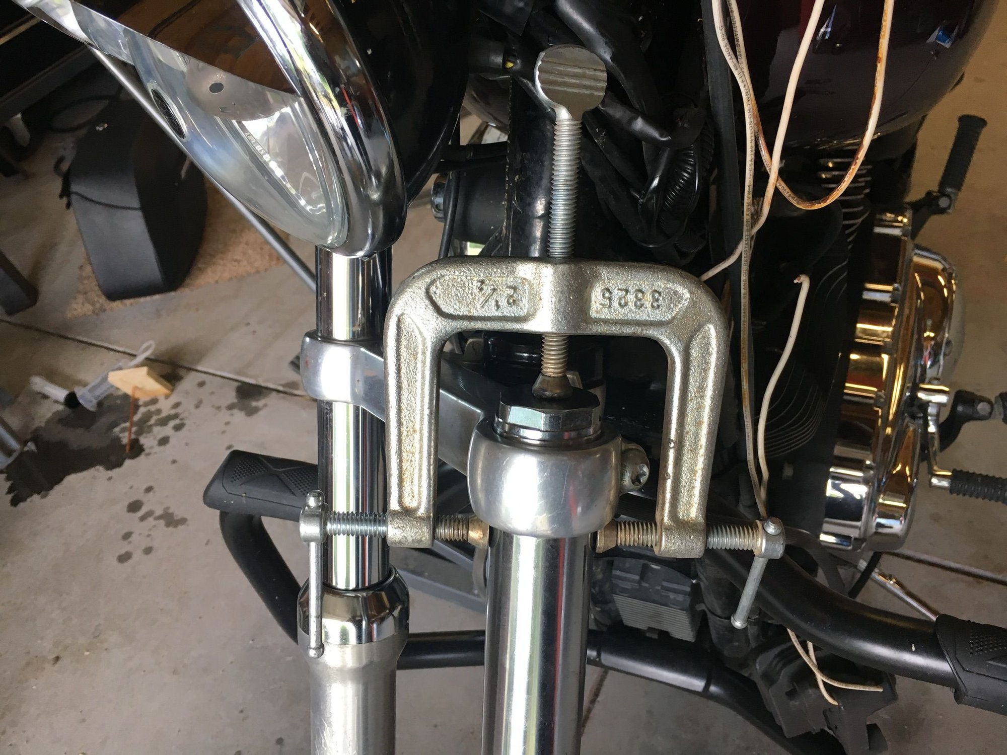

All I have are the stock tubes from the '07 low with stock springs. OK I didn't realize the aftermarket springs were shorter, thus needing spacers. Lord, I had a heck of a time getting mine back in, could not imagine cramming anything else in that tube.
Is there a secret to getting the cap back on, on the stockers? I ended up using a 3 post clamp to force the cap down close enough to allow me to thread it into the tube.

Oh yes, I did everything possible to gain more room. I have watched videos of guys that have one hold the tube and the other forces the cap down and on. They must be stronger than me. I could push the cap down but could not get the threads started that way, thus why I came up with the clamp idea.
I dropped the fork tube to the bottom triple clamp, and tightened the clamp. Then I put the 3 post clamp on. It does NOT clamp to the tube, merely touches it. The side arms use the bottom of the triple clamp to hold it down. Kinda spooky, since if it had flopped to one side those would have flipped off at me. Not good. I even still had to put the top post on top of the cap and force the spring down enough to slide the side posts under the triple clamp and onto the fork tube.
It worked but like I said, was spooky. There has to be an easier way.
