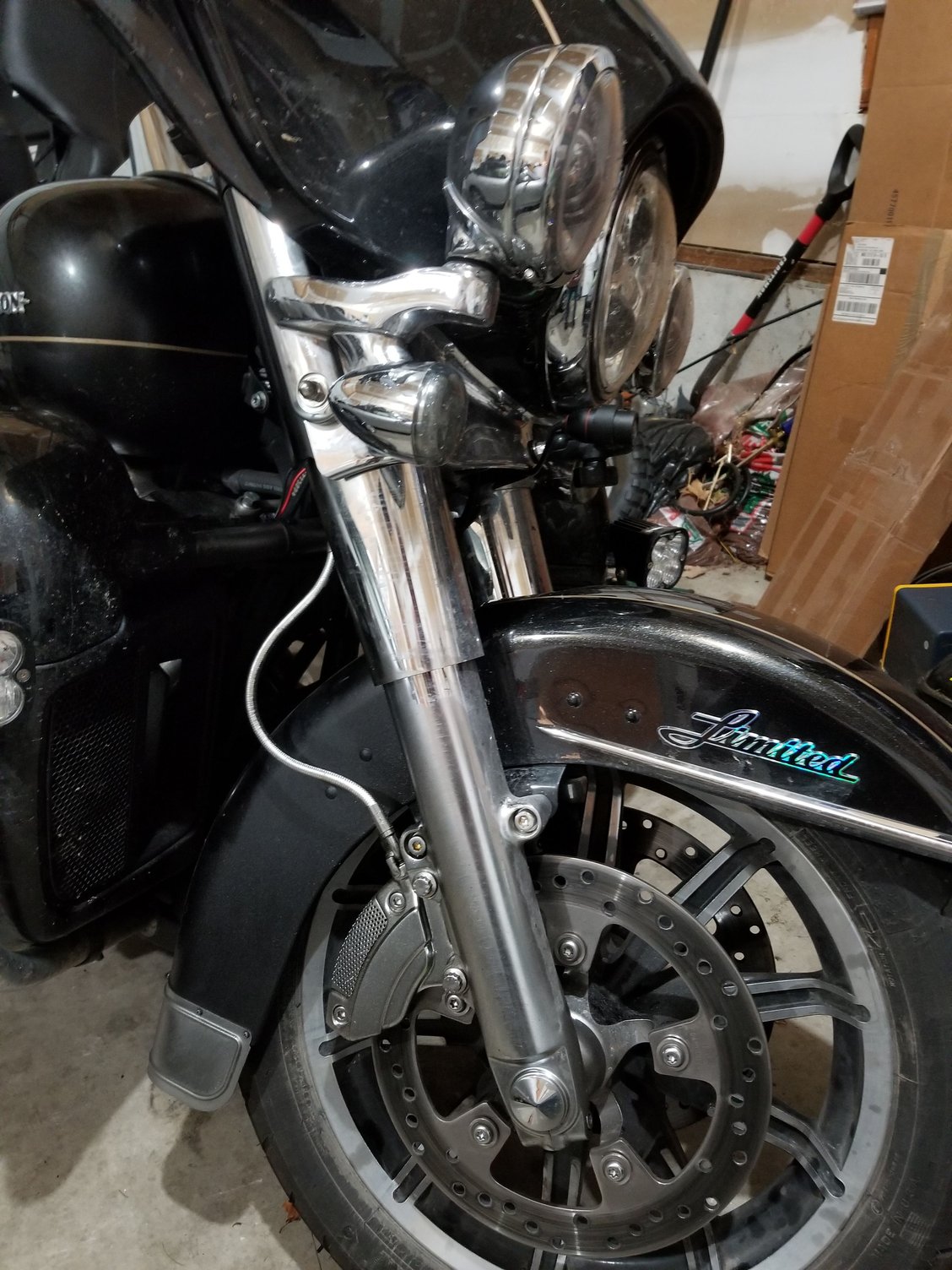

Ok, ignore the dirt. I ride a lot and just did a 1000 miles last weekend and haven't washed the bike yet. I am also currently uploading video samples for day and night front and rear so you can get an idea of quality. I am using it more for safety then anything else but it does take some damn nice video I think. I may need to turn off the logging of speed in case I need to use the video to defend myself though! LOL
Used the RAM mount
DVR is in the Dash. Had to drill a hole for the cabling but I don't take the DVR out.
As you can see a straight on view of the camera.
Rear Cam, it does get washed out at night due to the trunk LEDS. I may use a RAM mount here as well to get it past the LEDS. But you really can't tell much about the vehicles behind you at night anyway due to the Headlight washout.
Rear Camera mounted using the L bracket that is included from the rear trunk mount bolt.
Side view of the front camera and the RAM mount.
