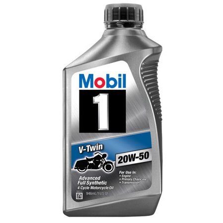

Mobil 1 V-Twin 20w50 all three holes.

Old Jan 8, 2019 | 03:36 PM
