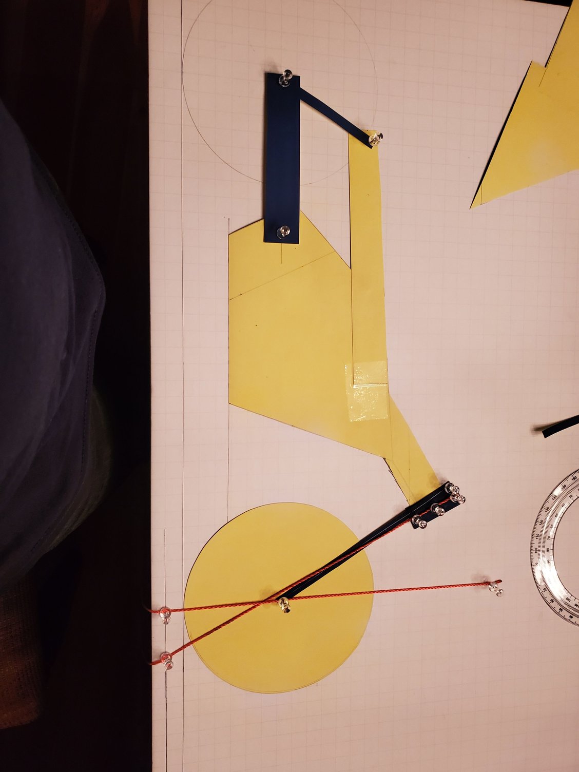

So, tried a little science experiment. Dont know if it will work or even solve anything, but I'm going to put it in action within the next few days. I basically made a 1/4 scale of the frame and suspension setup out of poster board and pinned everything to foam board as to be able to change neck rake and the rake and offset of the trees. While keeping the stock neck rake of 26 degrees and the additional 4.5 in the trees, I lowered where I attached the shock to the frame 1/4" (simulating a 1" longer shock in the rear), then 1/2" (2" longer shock). What I found was that for every 1" you add to your rear shocks, it removes 3 degrees or rake and 7/8 off your trail. If using a 14" shock, I'll have a 25 degree rake with a 3.5" trail. Very similar to a R1 with 24 degrees rake and 3.6" trail. I'm going to make a 1" extension block for my swing arm just to try it out, I figure it can't hurt to try.

So you want to reduce trail and think that it will make the bike more stable? Less trail should make stability worse.

I applaud you for your foam board work, but would greatly caution you about attempting to re-design the steering components. Not only is it expensive to do, but you're quite likely to make things worse. Especially based on what I'm seeing you describe as thought and direction for improved handling.
