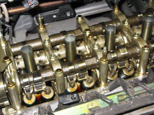

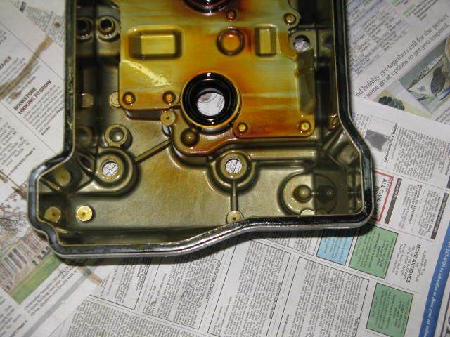

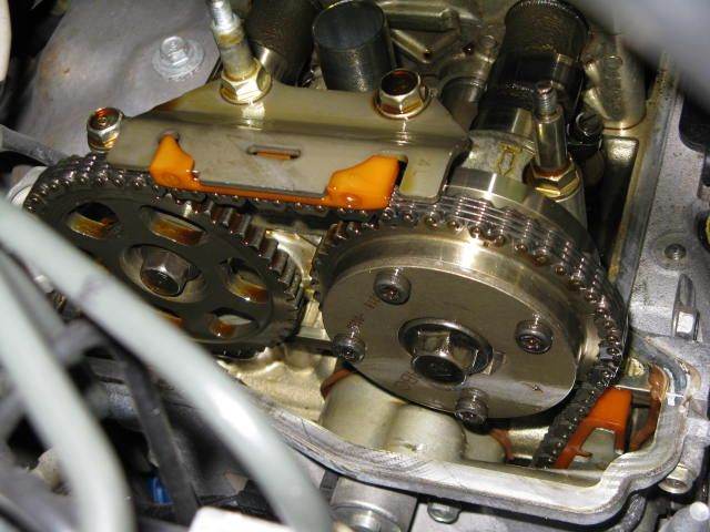

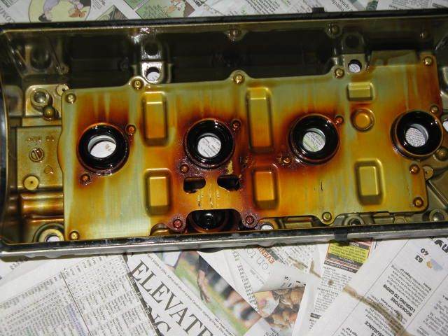

Of course there is no way to prove cons and pros of either way. However when it concerns warranty, you probably need to do it. However out of warranty, I have been into enough engines to know it does not matter. Time does not hurt motors or oil. Additives like some diesel and bike oils probably settle out. They do that even in the bottles, so shake them before use.
So a little moisture gets in from temperature rise and fall dropping moisture out of the air. Would do that with new oil. It evaporates off in out leg scortching two cylinders. Modern synthetic oils can easily go 5K even if it takes you 3 years. Filter can probably go 30K.
Know it's a car but I tested a new 2005 CRV changing oil ever year. Sometimes it had 9 K, sometimes as much as 11 K. 5W-20 Mobile 1 middle grade. After the first filter, filter ever two years. Took me almost 10 years before checking valve clearance and replacing plugs for the first time. Timing chain was still dead on. Absolutely no crud in engine.
Exhaust valves were about .001 loose. Intake still dead on. Gave the car to my college student and got RIP a new Subie to test. CRV looks and still runs like new.
