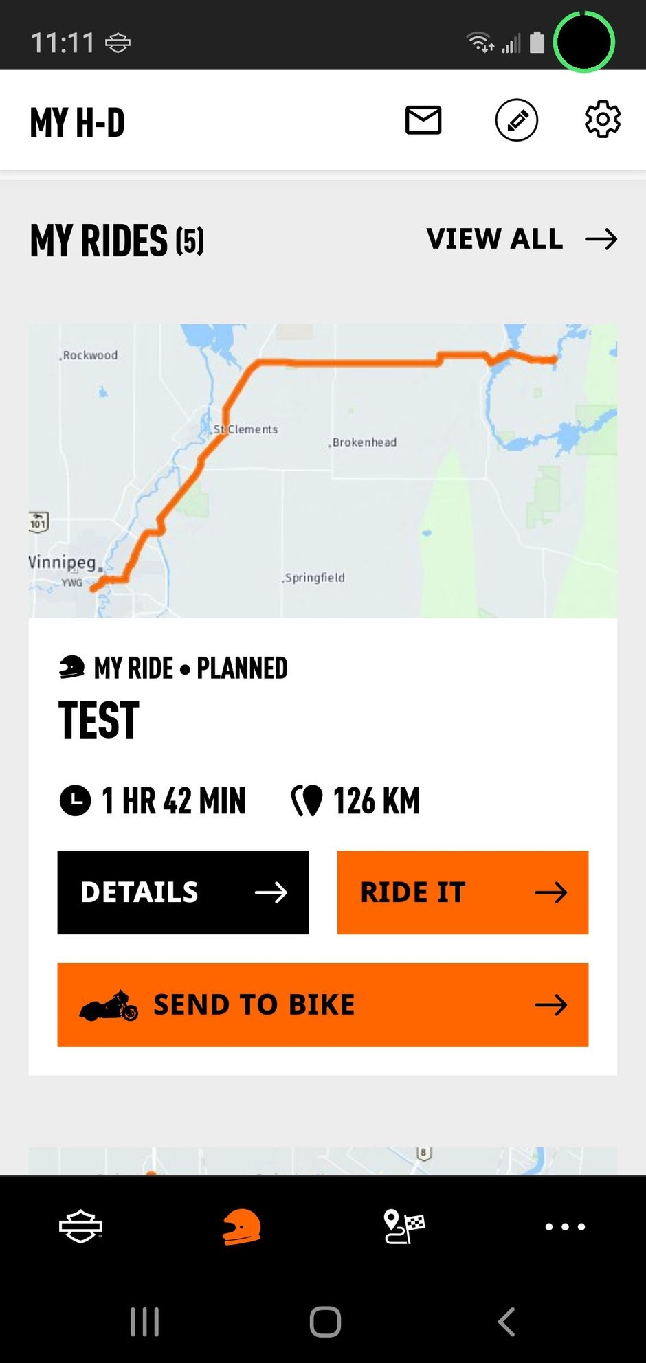

There is a way. But I have the GTS so not sure if it is the same with your GT...
1. Plot the route in the Ride Planner, either in the app or desktop.
2. When the app is opened and the route is selected, there shud be an option to ' send to bike'
3. once selected, it will download onto Boom automatically the next time u turn the bike om...provided the phone is connected via bluetooth
4. Go into Nav and select search...u shud see HD App ...select
5. Find your route and it will download and save
6. You start route from there or go to Rides to select the route when you need it
Its actually easier and qiick than it seems in the steps I outlined.
Good luck
here is a snap of a test route on the app for reference....note the Send to Bike option on the bottom

That is exactly what I was looking for!!! My problem it would seem is that I don't have the "send to bike" button. I even un-installed the app and re-installed it. STILL NO BUTTON!! So frustrating.

I double checked the app and it seems downloading a route via bluetooth only works on the GTS (2019 & 2020) equipped bikes.
It appears the app recognizes your Boom system and might not display the ‘send to bike’ option if you dont have the GTS.
sorry man, the usb stick might be ur only option.
