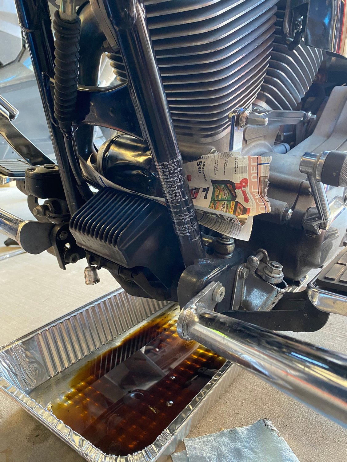

That’s the damage from torquing on it with a strap wrench. You can see by the thread where I started chiseling. That’s the only angle where I could get any purchase. Going to try the screw driver next.
Here’s the space I’m working in. I agree taking off the wheel and fender and other components would make it a lot easier. At my level, I think that’s too much to handle.

Just get a tierod fork tool and drive it into the end of the filter
then if no hole in the handle lock on some visegrips and a bar on them for leverage.. it will come off.
Where are you located?
you can buy cheap tierod fork from harbor freight or eBay
