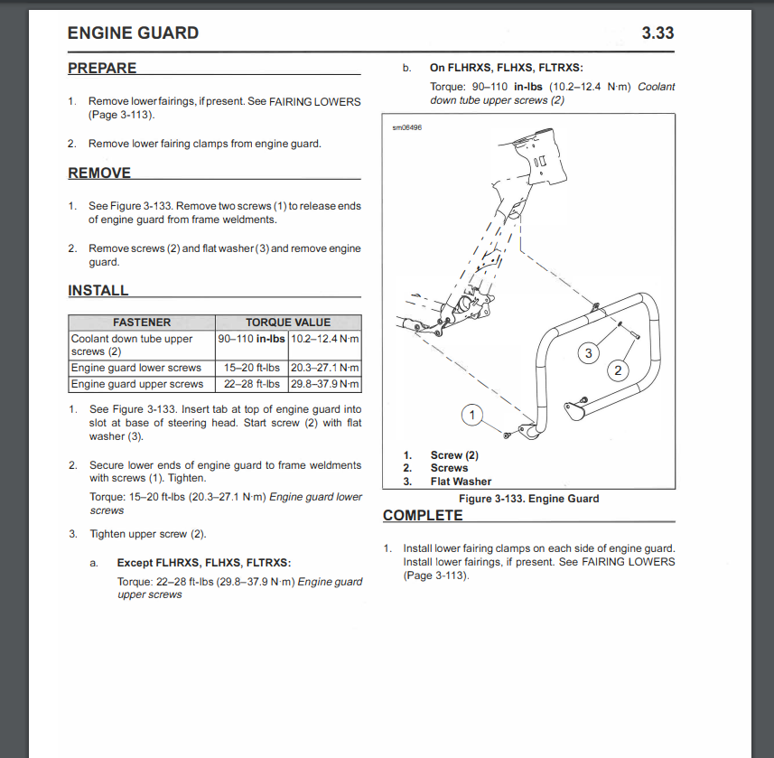

Hey guys... I have a 2021 Road King and am replacing the engine guard. My er ... "alternative" service manual shows the torque value of upper screw at 22-28 ft-lbs ... the lower screws at 15-20 ft-lbs. This seems in error to me as the upper screw is much smaller than the lower screws and 22-28 seems too much. I looked at Harleys online parts catalog and their instructions and it just says to refer to your service manual.
Can anyone confirm these torque values for me? Cheers!

Here is a view of the page I have:

Well it appears the torque value is correct and got it installed. Figured best to ask versus potentially snapping a bolt.
