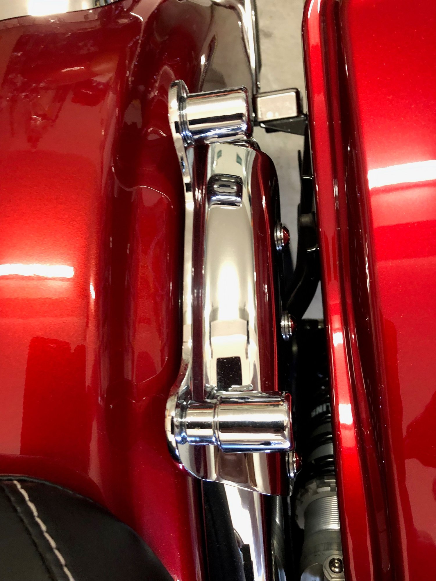

Pics would help but this is your first post, so not sure if you can post a pic yet.
For comparison, below is a pic of the clutch side of the 4-point docking on my '13 King with the seat in the lower left corner. There should be about a 1/4" gap between the fender and bracket.
