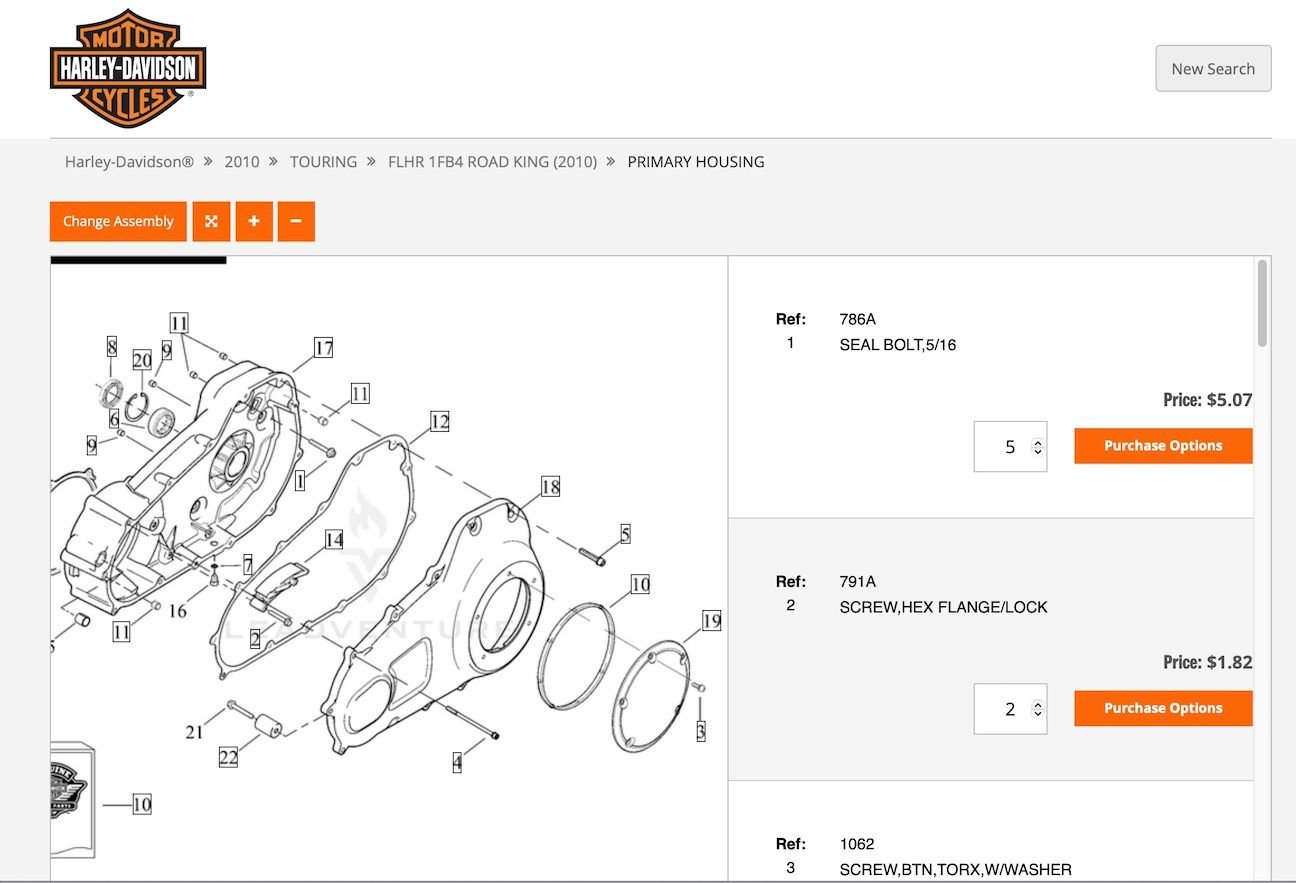

If you only take off the derby cover, you won't be able to inpsect the compensator, auto tensioiner, and see if the clutch basket has been wobbling and scraping into the inner primary cover (signs of a worn IPB)
I suggest taking off the outer primary cover. Consult a factory service manual for the torque specs and torque sequence (removal & reassembly) for both Derby & primary covers. Both cover's gaskets can be reused if not damaged during disassembly.
It takes like 5 screws, Derby Cover and 13 screws, Primary cover. Depending on how old (time and/or mileage) of the primary fluid you can reuse it, but it's only like a Qt.
Once both the Derby cover & Primary cover are removed, you will be able to inspect the all primary components...

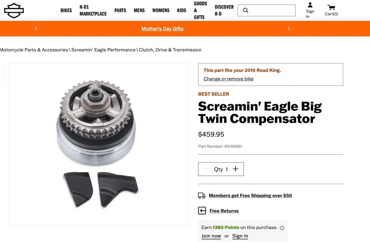

won't be getting dark horse after all... way to expensive to bring in from anywhere... looks like screaming eagle compensator....
Old Apr 29, 2025 | 09:04 PM
hattitude's Avatar
hattitude
Posts: 14,148
Likes: 11,221
From: San Diego, CA
Hopefully, he will be getting you the #40100061 Screamin' Eagle Big Twin Compensator.
It is the retro fit comp for your year bike, that is the same as the one introduced with the Rushmore bikes in 2014. It is much less problematic than it predecessors (2006 - 2013).
It requires installing a the new style rotor, but that rotor comes with the comp above. It will cost you more in labor than other choices, but it gives you the newer, better spring pack that is independent of the rotor.

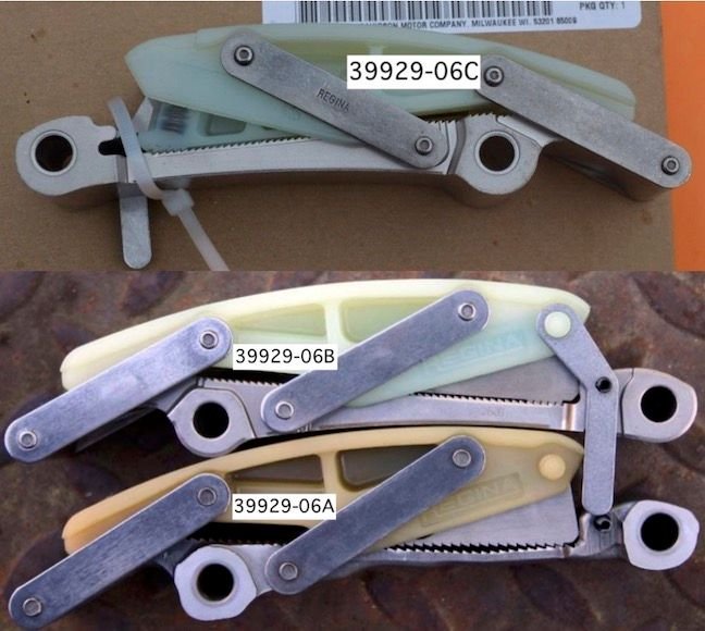

If your mechanic thinks the clutch bearing is the main issue, it can be caused by the auto primary chain tensioner making the primary chain too tight.
The same year HD introduced the new compensator that turned out to be very problematic, they also introduced a new auto primary chain tensioner that also proved to be very problematic until a better version was introduced around mid 2010.
If he hasn't mentioned it already, have your mechanic check to see if you have the #39929-06B or #39929-06C tensioner. If so, and it is in good shape, you have one of the good ones. The #39929-06 and #39929-06A versions were problematic and would often overtightened the primary chain. If you have other than an "-06B" or "-06C" tensioner, IMHO, it would be worth adding the replacement version, currently "-06C", to avoid a recurrence of a clutch bearing issue.
I hope this information helps...
Good luck with the repair.
