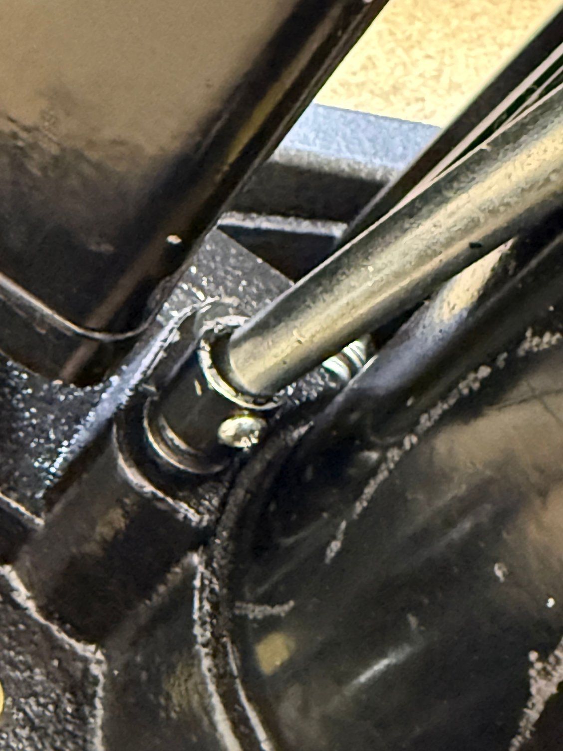

Here are the pictures you requested. J&S offered either the air assist or the manual model when I ordered my lift. Hopefully someone can identify the jack as there is no name on it. There is a patent number which I am going to search. Hopefully I can find something about it.

I stand corrected....Thx for the pics. You have one of the very "rare" optional "air assist" units.
