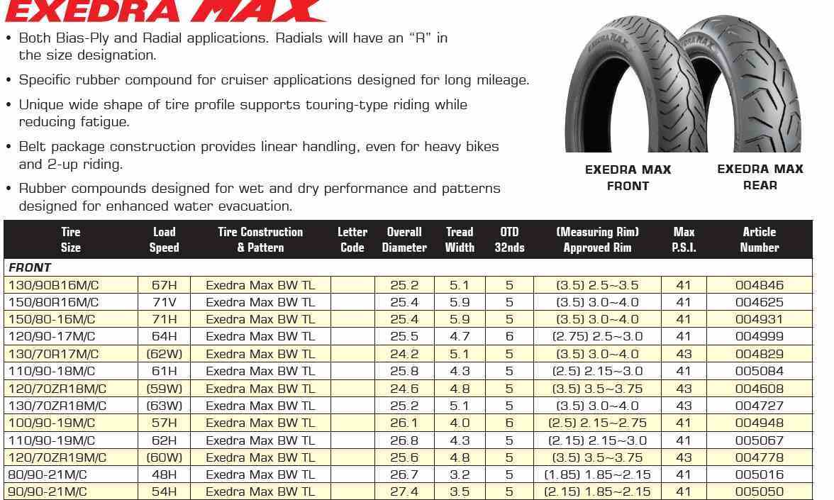

Dropping the 5 inches of trail to 3.28 with a 21 to 19 tire change.. About the only way you could do that is if you forgot to put the tire on. What calculator are you using? What numbers are you inputting?
What size 21 are you running? What size 19 do you want to run?
Going from a 80/90-21 to a 110/90-19, you are the same size..
I run the 110/90-19 excedra tire on my bobber to get ground clearance for cornering. Bike is a softail with 33 degree for rake and FXDX front end.
I run a 110/80-19 Bridgestone T32 FXDX with 28 degrees of rake..
I've run 90/90-21 on softails and they are significantly taller than the 80/90-21. You get about 9mm more rubber on the tallness of the tire..
