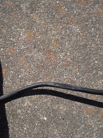

Just replaced mine and found the issue on the lead to the breaker. Good luck reaching yours.
