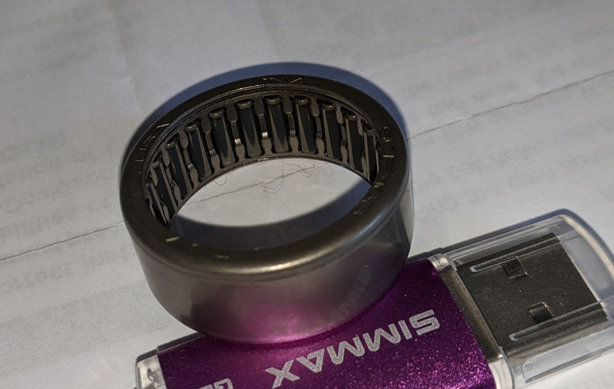

There is no easy option sad to say. Patience and perseverance will get you there. I dug the Standards old cam bearing out of the drawer and had a tally up for you,
you should have 24 rollers and 24 pieces of cage, so less what you have found already, means 17 rollers & 12 pieces of cage still to account for. I'd scour the floor around the bike with a magnet first to ensure you don't waste time looking for a roller that's hidden itself under the bike. I'd flush out with kero or diesel at the end of the search anyway, to wash out everything.

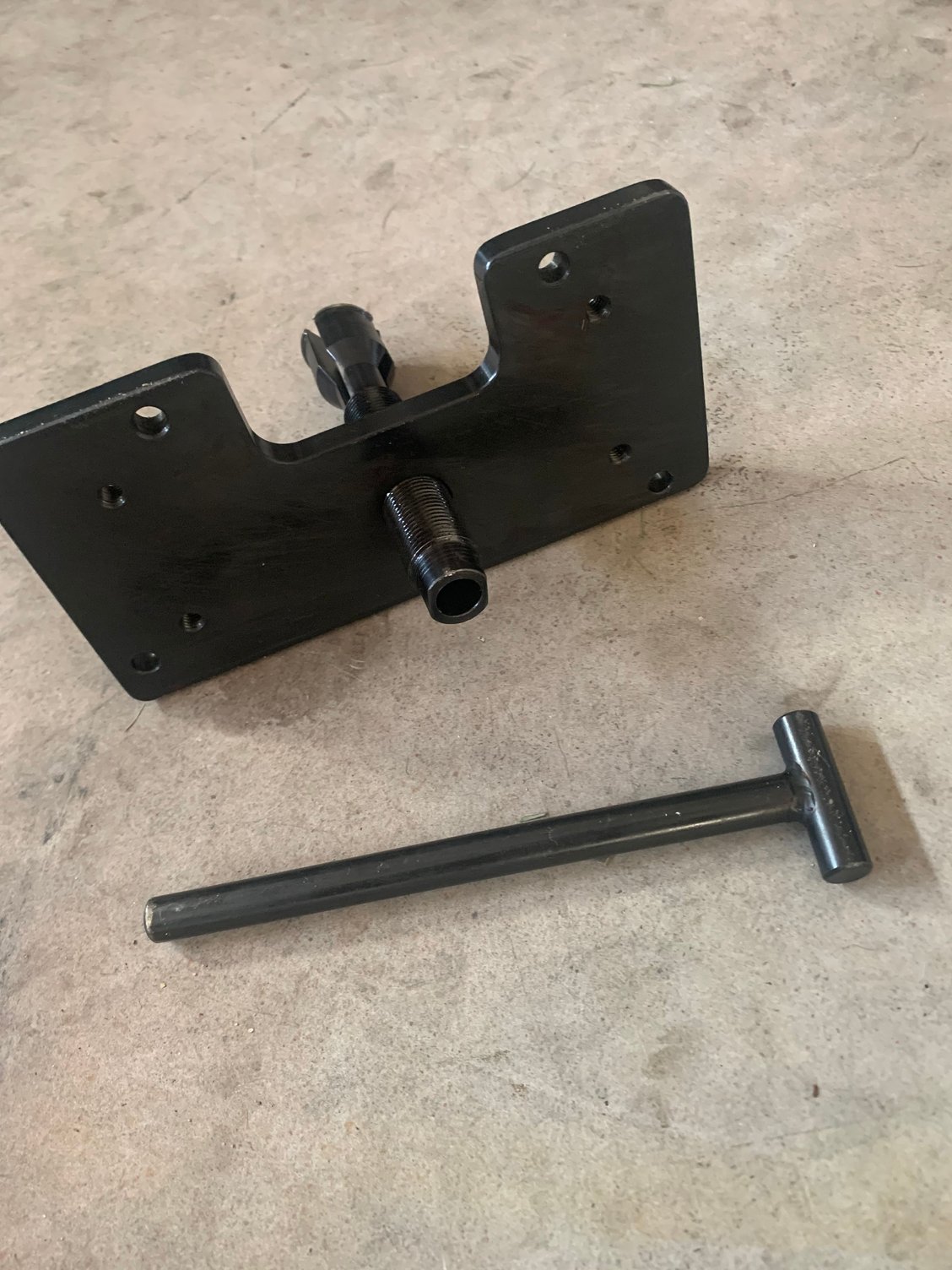

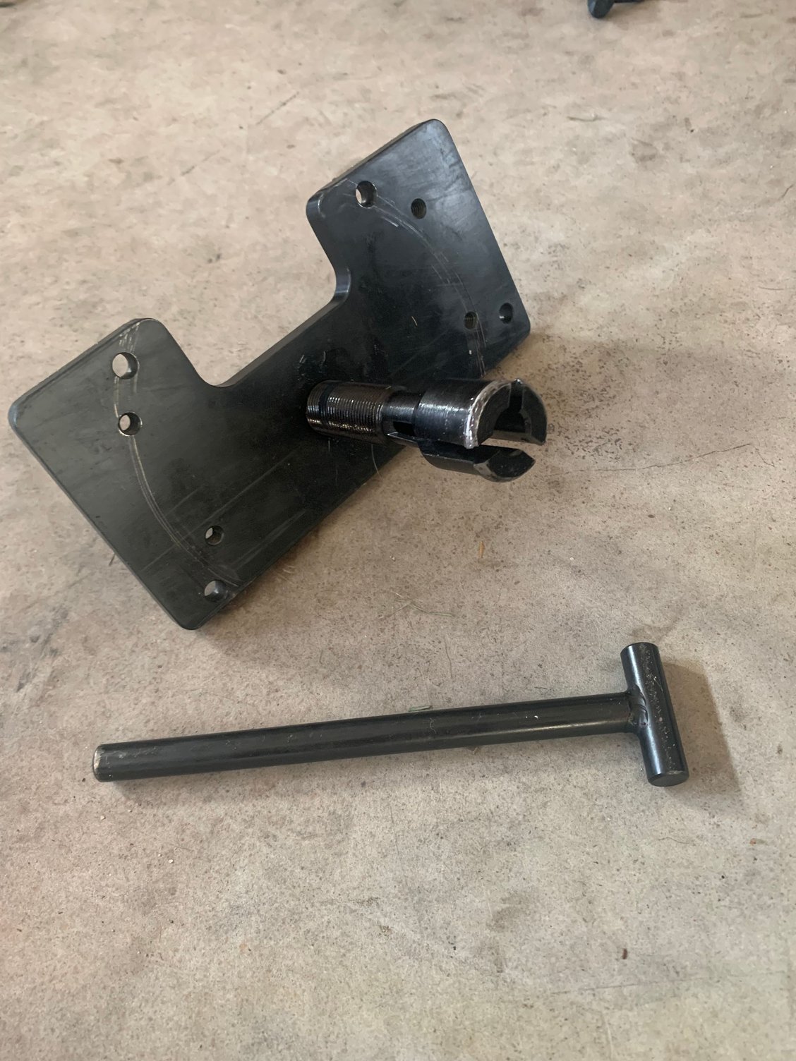

I'm with supernac. My inexpensive Borescope has an attachable magnet to it. But I'm afraid pulling one jug may be the way to go. I think I can speak for all, we'd like to see the puller you used. Was it a bolt on plate type with the full collett?
yes I used the puller from Fuel Moto

Originally Posted by OldMike
Yes, inserting the collet takes extra care to make sure it has completely reached the bearing housing edge and snapped into place before pulling. I also noted on some new pullers that the collet jaws can be a bit stiff and needed to be compressed a bit with pliers to make it easier to insert but keep enough stiffness so they can snap back open at the other end of the bearing.
Pulling that bearing and lifter cuff bolts really got my attention.
Good luck.
Yep lube that collet up good and make sure it’s behind the bearing. Like you say I remember that snap once it was through. Then spin it and give a little tug to make sure. Then insert the T handle.

This is why I kinda like the old blind hole slide hammer. It would not have wreaked the bearing at least; the extraction forces are less.

One of the best tips I've heard is to make a mark on the shaft so you know it's fully inserted. And then keep an eye on it.

In a past thread (same issue) the OP spent days trying to get a single lost roller out of the bike. Seeing as you have so many missing rollers, I'd split the cases, considering it a smart insurance policy. If you have the money, send that crank to Dark Horse while you're in there
