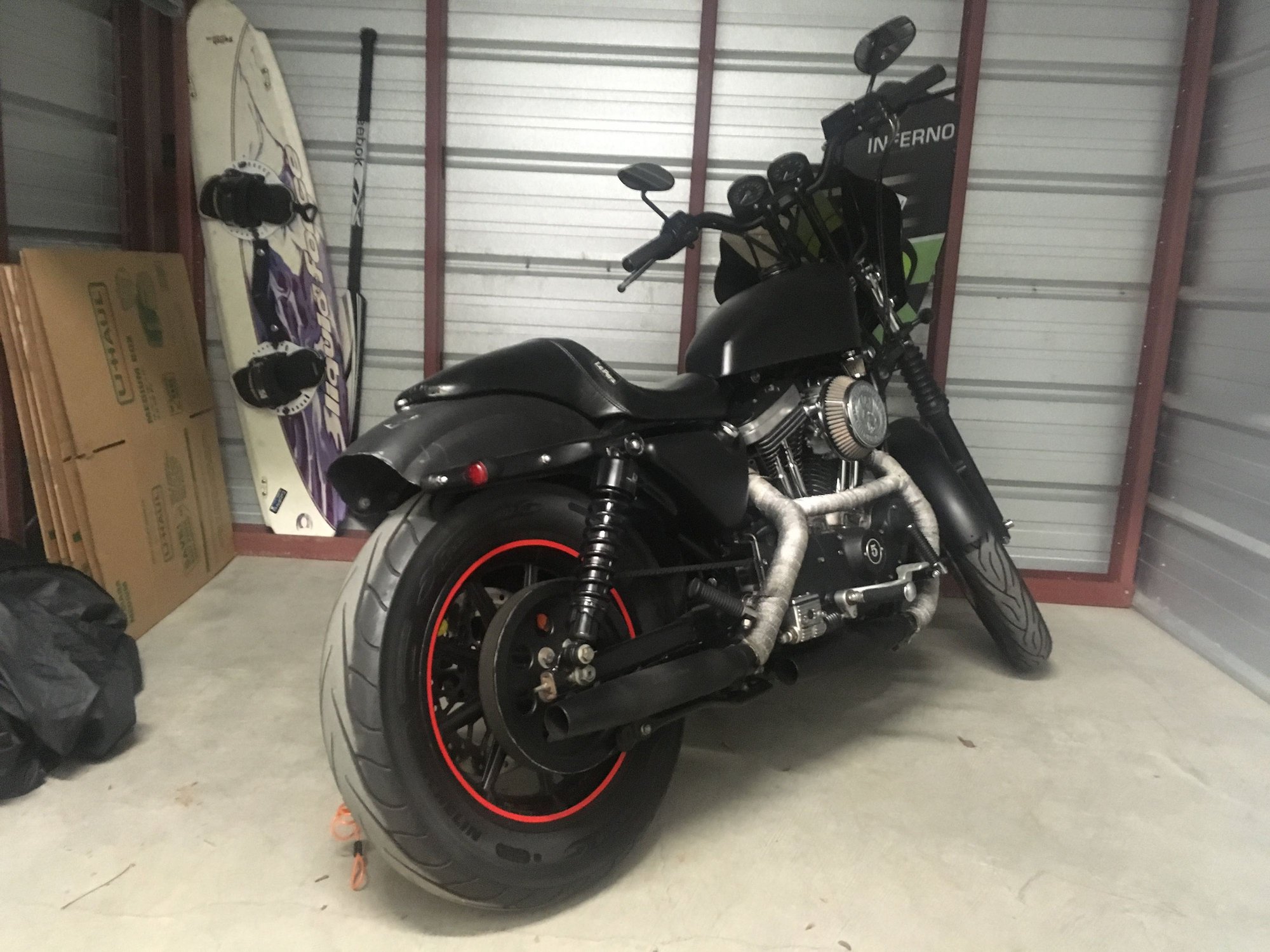

Winter is finally coming to an end and it time to pull my Harley out of a storage!

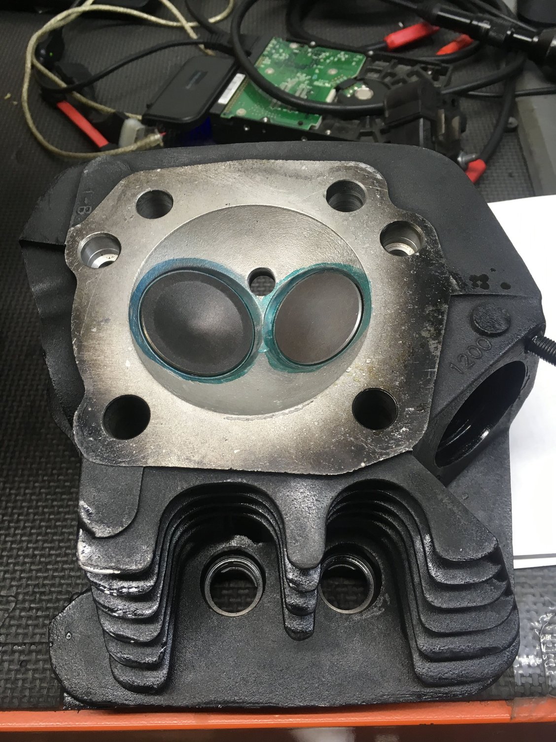

Decided its time to replace those broken exhaust studs and since the only way to do it is to remove the heads, I'll put new valve seals and rub properly valves into seats. A machine shop will also shave the heads tinny tiny bit, nothing crazy, more like polishing.
  #107
Old 04-23-2018, 03:54 PM
Rokolya87's Avatar
Rokolya87
Rokolya87 is offline
Join Date: Jun 2017
Location: Palo Alto, CA
Posts: 70
Received 9 Likes on 7 Posts

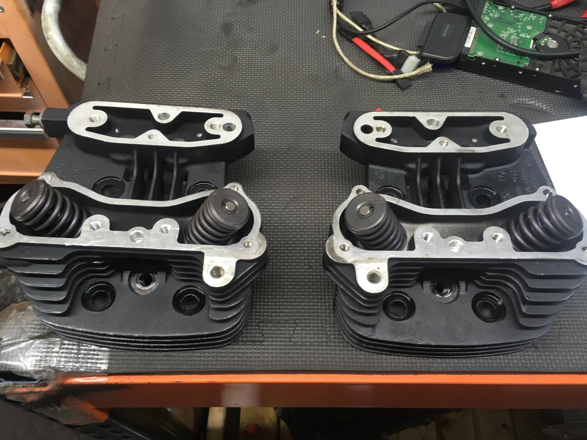

Just pick up the heads from the machine shop.
Broken exhaust studs - fixed;
Valve guides - replaced;
Valve seats checked and valves were re-rubbed into the seats.
They decided no to machine the surface of the heads that touches the head gaskets, so we won't mess up the hight of the combustion chambers.
I'll just polish them gently, so there won't be any paint on it.

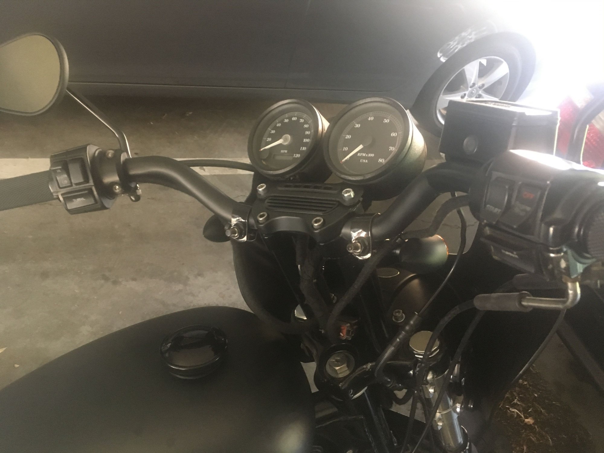

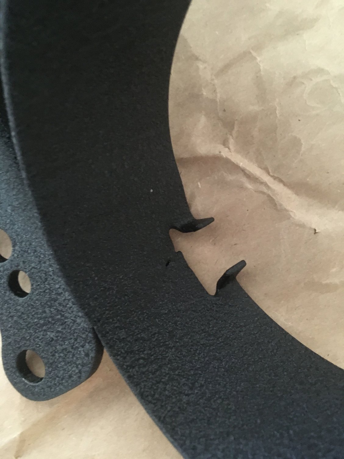

Finally fixed the speedo! The bracket was also rewelded and powder coated. A cracked glass was replaced. Looks brand new!

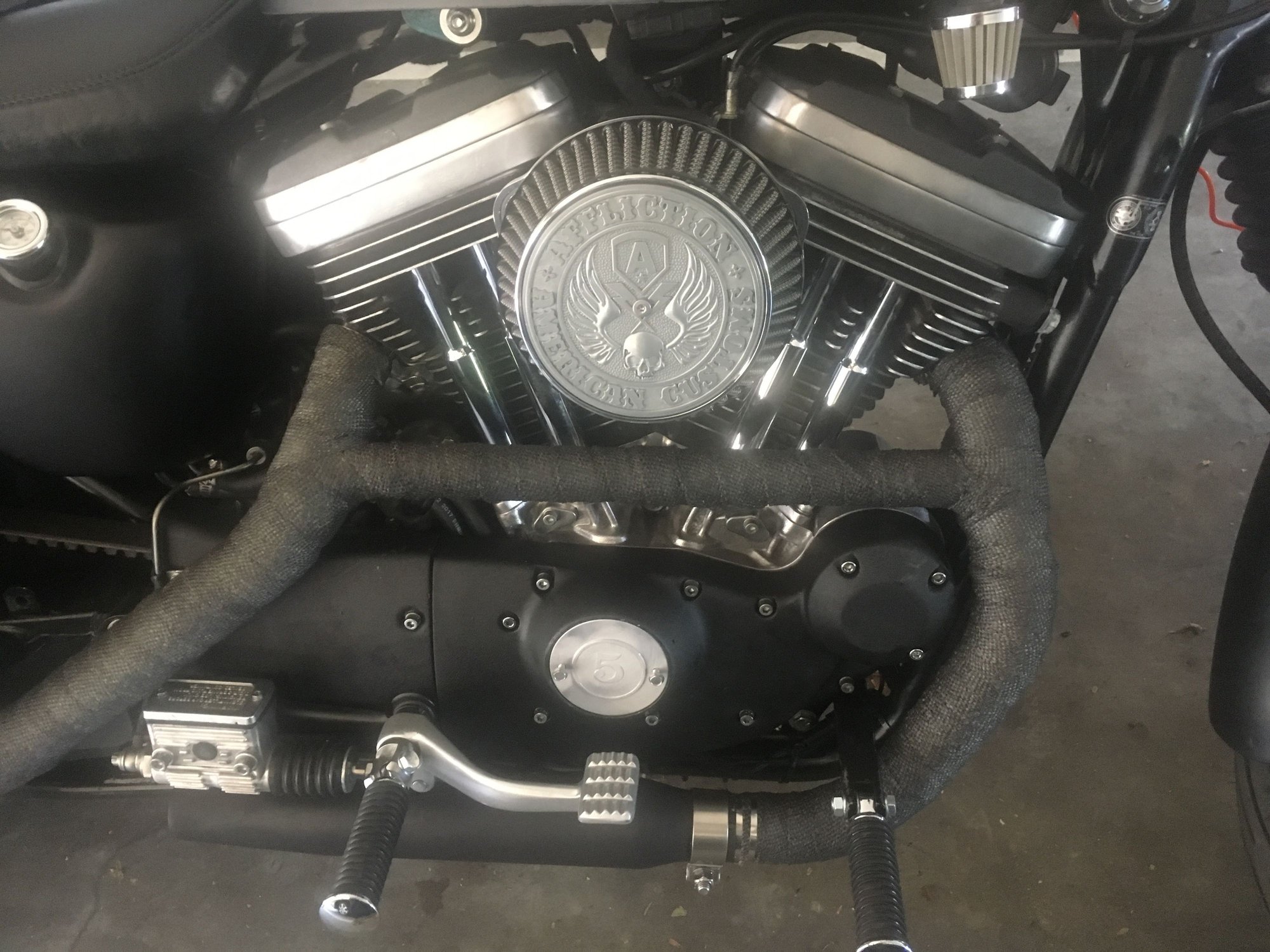

The engine is serviced! All new gaskets are in. Just clear the carb and put new exhaust wrapping!
