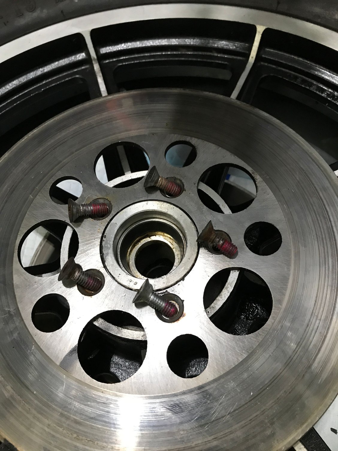

Well, on the discs, the slot-and-hammer method worked:

Unfortunately, it didn’t work on the caliper fork bolts. Tried heat, PB Blaster and an impact hammer. Ultimately, had to use the Dremmel to cut the bolts in half. One was STILL stuck in the caliper...
