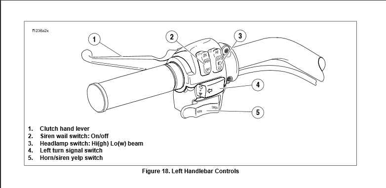

http://www.fiveseasonssportscenter.c...2001)//HANDLEB
I don't understand exactly what you are looking to do. I think you are talking about switch #2 - Siren Wail On/Off. That switch will probably not function without the police siren package on the bike. The public usually doesn't get the package with the bike, usually removed by dealer.
Your horn should work with switch #5 - Horn/Siren Yelp which is a spring loaded momentary switch. The Siren side would have caused the siren to give a quick yelp while the Horn side should cause the horn to beep. The siren side is most likely non functional because the siren has been removed. The horn should work.

Here's part of the wiring diagram for the Left Hand control for your bike
https://serviceinfo.harley-davidson....b-5a4bbfa5b8f0#
