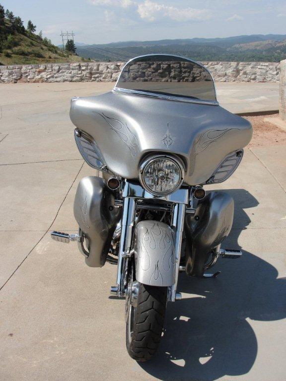

You can do pin stripe flames that are nice and fairly durable.
They very rarely need touched up.
I've had mine on for 3 years and they still look good.
Had a couple areas touched up but nothing that took over a couple minutes.
A cheaper alternative.
