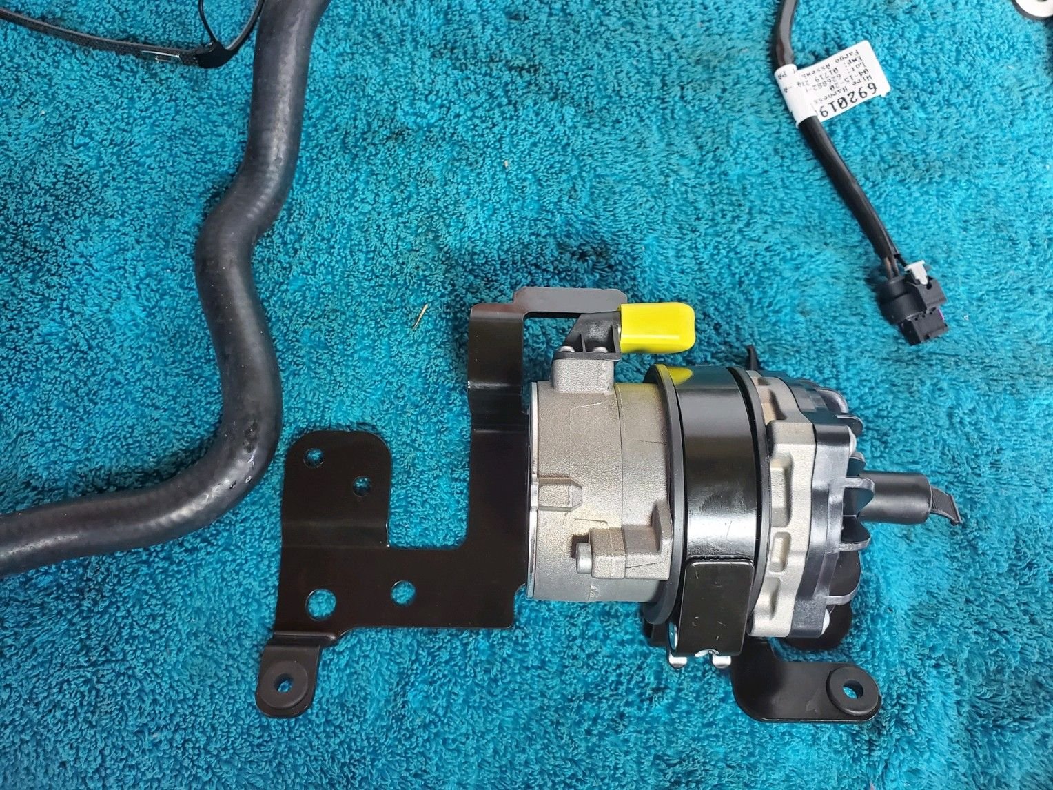

Just received the new design replacement coolant pump kit (pn 26800107). The kit contains 2 different types of hose clamps. The instructions indicate one type of clamp (pic below) requires a special HD tool (HD-52004). These clamps appear to be self energizing. Install the clamp on the installed hose, remove the yellow plastic ring and you should be good to go. Am I missing something? Did Harley change the clamp design and not update the instructions?
It's the other type that is supposed to require the special tool. It doesn't though, you can just use pincer-type pliers, eg
