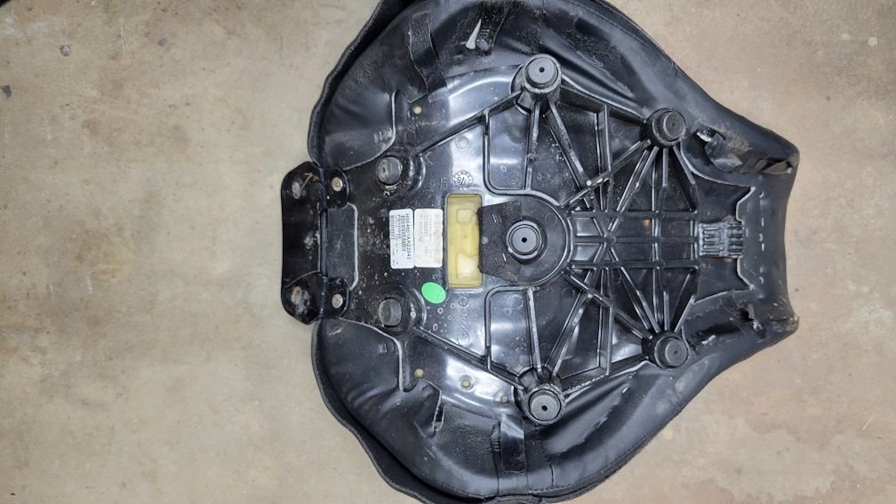

--The rider seat itself is torn underneath and had black electrical tape covering the tears. No biggie, works fine and is being replaced anyway.

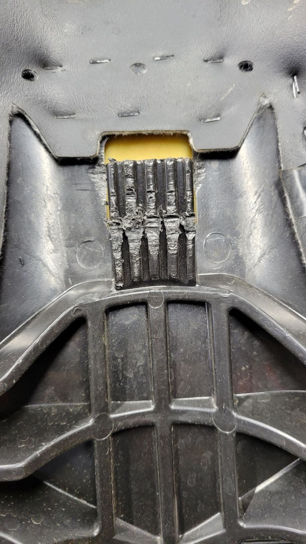

--Tab under rider seat is chewed up pretty bad. Again, being replaced so not a big deal. Just indicative.

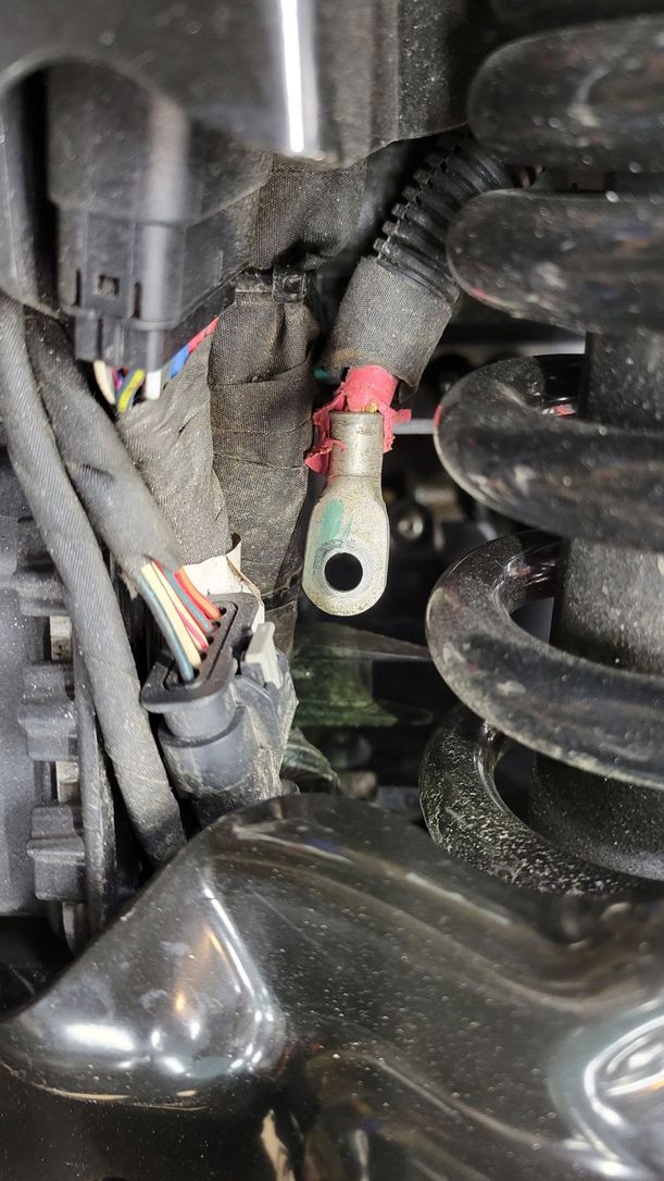

-Positive battery cable shroud is tattered/torn

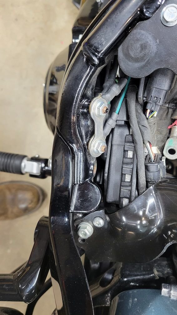

I pulled the battery and put it on my tester. All good. While in there I tightened the two connected grounds on the left of the frame right above the battery and checked every other fuse. All good. Decided to put it all back together with these minor corrections (and a good cleaning). Tightened everything properly and fired it up. It's never started so strong and confidently. Awesome, problem seems to be fixed. We'll see in the coming weeks.

Underside of seat
Tightened these grounds
Positive battery cable shroud torn
Underseat tab chewed up

--Did I get some kind of parts bike or did the previous owner just gorilla everything, trade it in and now I get to fix it?
I'd go with that, way too many red flags on that bike.
Someone on here has a signature line to the effect of, the worst thing to happen to a Harley-Davidson is the owner..(Very loosely paraphrased)
Sounds like previous owner isn't mechanically inclined.
Sucks you're having so many issues, 2018+ FLHCS are great bikes.Hope you get some sort of remedy to this.

A dropped bike might explain the missing windshield and maybe the apparent angle on the saddlebag bolts. I wonder if the fender support is tweaked a bit. It's likely not a big deal but I'd check the wheel alignment just to be sure you've got a straight frame. I can't explain the mess with the underside of the seat. It seems like the rest of the issues are electrical and you're on top of it with your battery connection clean-up. That bare handlebar wire is a concern. Maybe somebody tried to change handlebars but got over their head and aborted the mission, who knows.
The velcro arrangement on the main fuse holder looks non-stock but it's on my '19 too. Also, an occasional wheeze upon stopping is completely normal with these engines. You shut the motor down at a certain spot and it will equalize pressure. I don't know why my twin cams and Evo never did it but the M8's do. My motor is also a bit 'clicky' at times, definitely more mechanical racket than any other bike I've ever had, except maybe my old BSA's.

The chewed-up positive cable sheathing might be caused by clamps from jump-starting. Might explain the seat wear as well (on and off often).
