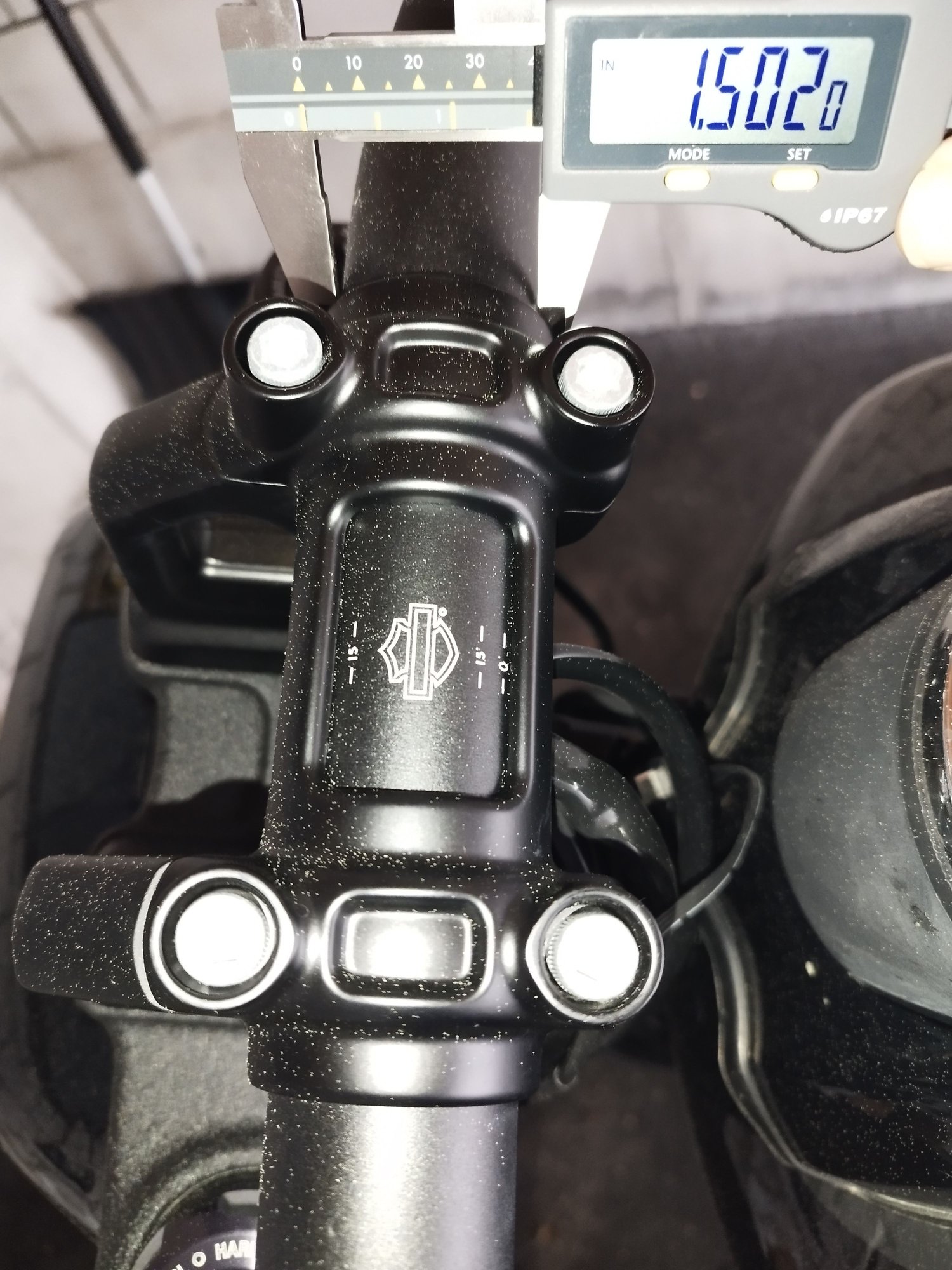

Originally Posted by $tonecold
That clamp is Harley Davidson. The website says it's not for the Fat Bob, but they aren't always accurate on what fits what.
The Fat Bob has 1.25" clamp.
If that were the case, I wouldn't have any trouble finding a suitable clamp. As you can see, the Fat Bob 114 has a 1.5" clamp. ​​​​​
I guess they say it's not for the Fat Bob 114 only because of the bigger clamp. I ordered the speedo at my own risk...
I stand corrected. Harley shows handlebars for the Fat Bob that are 1.25" diameter.
Old Apr 19, 2024 | 01:28 PM
FatBob2018's Avatar
FatBob2018
Joined: Nov 2017
Posts: 4,237
Likes: 3,102
Yes, but... look in the specs and you'll see that you have to buy their 1.25" bar adapter set to use 'em. I know, I'm using their Fat Drag bar (a 1.25" bar), so I have their spacers installed to allow for 1.25. The actual stock Harley bars are indeed 1.50" at the center clamp.

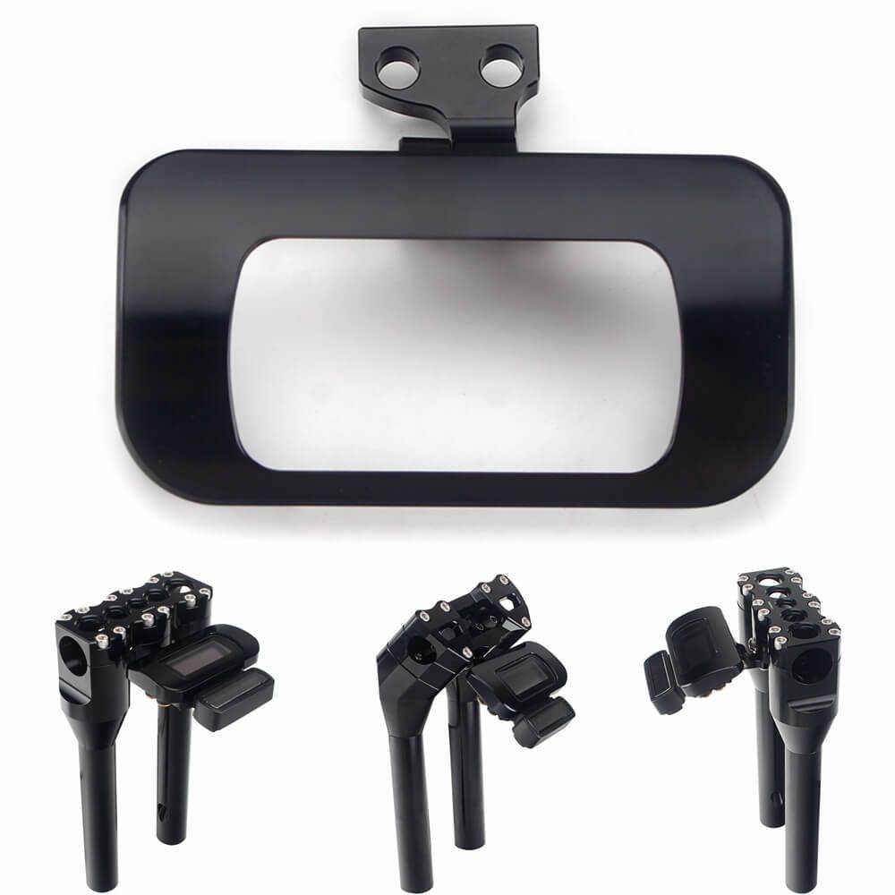

This could solve the problem.
I want to mount the Koso D2 on the handlebar because I want to mount a larger tank later and it is better in the field of vision there.
Old Apr 21, 2024 | 10:16 AM
$tonecold's Avatar
$tonecold
Joined: Feb 2011
Posts: 4,679
Likes: 2,180
From: Gilbert, Az.
I would say you have two options, change to handlebars that have a 1.25 or 1” clamping area and change your risers and clamp, or fabricate a speedo mount that will work with what you have now.
