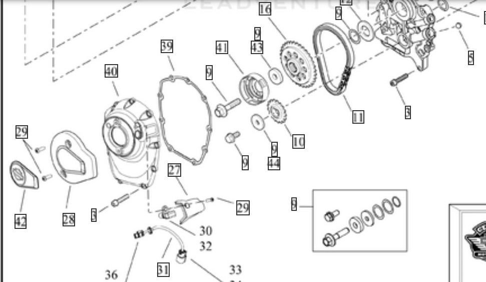

Originally Posted by Powermankw
Tell that to my Street Bob that is VVT... New Lowriders are VVT... 121s and 117s.
Although there are changes to the cam drive on the '25 Softails, the components that actually give the engine Variable Valve Timing are missing. The only models that currently have this are the 2025 121 ci. CVO Road Glide and the CVO Street Glide, the 2026 117 ci. Road Glide Limited & Street Glide Limited, the 2026 121 ci. CVO Road Glide/Street Glide, and the 2026 121 ci. CVO Street Glide Limited.
Here is the cam chest on the 117" '25 Softails.
Here is the cam chest on the '25 121 ci. VVT.
The parts that enable VVT are the variable drive gear for the cam, part 14, the cam phaser, part 24, and the VVT actuator solenoid, part 29. These are missing in the 117" and 121" HO models. The advantage to VVT is a much flatter torque curve, although the over all power seems to be less.
Thanks for this. You saved me the trouble.
