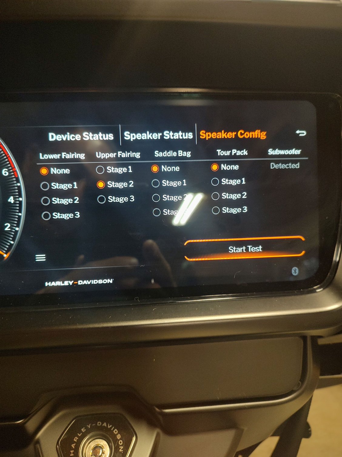

I have a streetglide with stage 2 audio,and fairing speakers only. I just did the USB 2 update. My os is 5750D and thats what it should be ,, But the amp still shows 1540. And now I have options for saddle bag speakers and tour pak speakers and lowers speakers.... Is anyone else getting this TIA swifty.

Its being reported that the OTA is not down loading the complete update, its a hit or miss for the amp and Cal file, those are available separately on the HD site for down load on a Thumb drive, If your display is not the same as Swifty's above, your download is not complete..I did the OTA and do not have the same display, going to do the Amp and CAL today on the Thumb drive.
thanks, please report back...is the Battery Drain fix supposedly implemented with the incomplete OTA? that's all I really GAF about this go around
So you are saying this is the way It should be?????????
