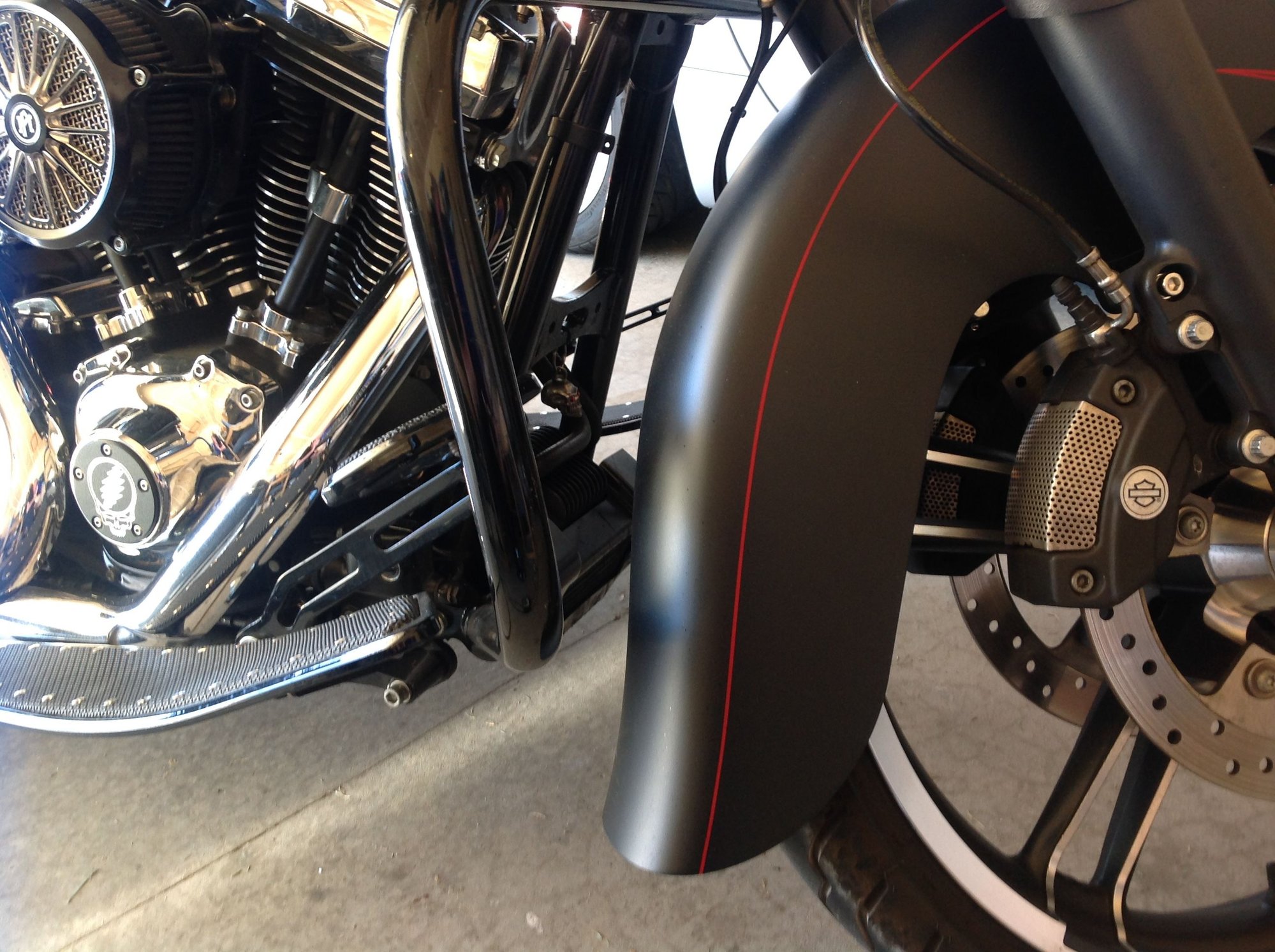

Just a heads up you have to pull fuel tank and air cleaner to install these. I did it like this.
Start bye painting JL grills. Note there could be warranty issues if you do this.
Remove old lowers and any tape you may have used to have them fit tight clean all the bugs off could not get to before. voodoo lowers fit like a glove.
Start with the r/h side try to find spot on crash bar that will look straight and also allow clearance of speaker and fuel tank its a pain cause inserting 8.8 into lowers then setting fuel tank back on and trying to hold them where they will actually sit when screwed on to lowers is two different things there is very little mounting surface and if not just right mounting screws will not have enough meat to hold also trying to get JL emblem at angle you want.
mark holes double check all holes are centered in mounting flange drill vacuum out pods and mount.same for other side but the trick is to get JL emblem to match r/h seams easy but telling you these speakers are heavy and have nothing to rest on in inner pods so the alignment is tricky.
Gannicus i have curse of being short and could always hear lowers but what i hear now is night and day different than mmatts hertz bt had there.But also agree its a system not single components so dont think there for everyone.
Alex, cant wait to hear your though's don't think your a jl8.8 fan per say.But maybe you can come up with something that fits and has better cost/bass with less power needed.but bet you end up with these pods on your comp bike.

15 street glider ill check fender clearance think brake and floor boards will be ok main thing is has to be Harley stock style crash bar.
gan i did say he was not fan of 8.8 but they are made for it and to install another speaker will take some glass work to the small lip in cut out for speaker
where you see the mounting screws in this pic there is no inner mounting surface left for anything smaller diameter wise. he has shop next to him that can fix this i am sure but not me at this point.
They can ship them uncut so you can cut them out for an 8". The grills like the ones from Lex Rivera will fill in the space around the speaker for a clean look.
